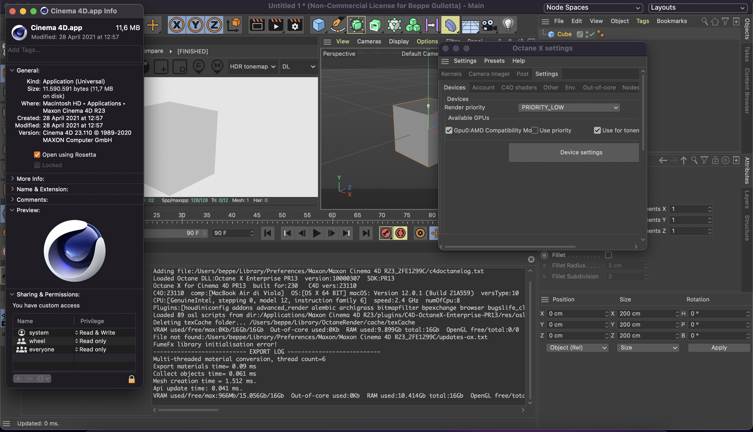

M1 chip is supported by C4D-OctaneX-PR13 for Monterey, but only if you enable the Open with Rosetta option, in the get-Info panel of the Cinema 4D.app:
OctaneX is still based on 2020.1.5 SDK, with some addictions, while PC version is evolved at 2021.1.2 SDK.
We need to wait for the next upcoming 2022.1 SDK, to have an OctaneX version based on the same SDK as CUDA, to be able to have a native M1 Apple Silicon version for plugins.
