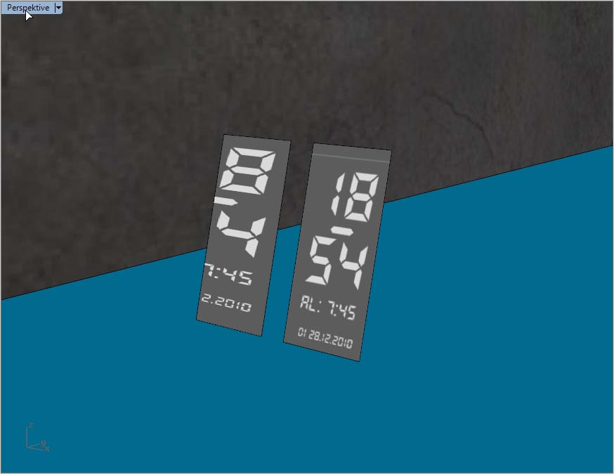

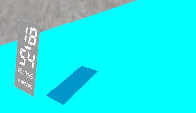

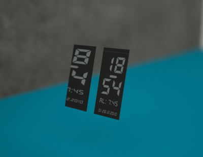

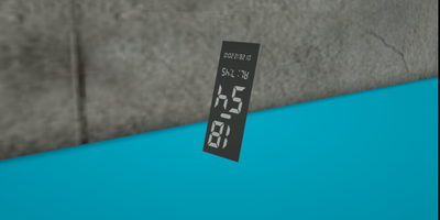

Hi Sam,
thanks for your answer!
Unfortunately I am not having good luck reproducing what you are seeing.
Does that mean, you have the right picture in octane? I mean the numbers in the right orientation?
Or you´re just unable to open the file?
I do see is that the surface has two mapping channels. If you remove both of these in Rhino that reapply your mapping, does that help?
I tried everything I could think of. I made a new plane without any maps and for scientific reasons flipped Normals and UV in every possible direction. I then applied a decal in rhino and rendered it. Now, for a change, the image was upside down.
It would be easy of course to take the image and rotate it in gimp, but sometimes it is flipped, sometimes rotated. And that´s a bit uncomfortable when you have more than just one image...

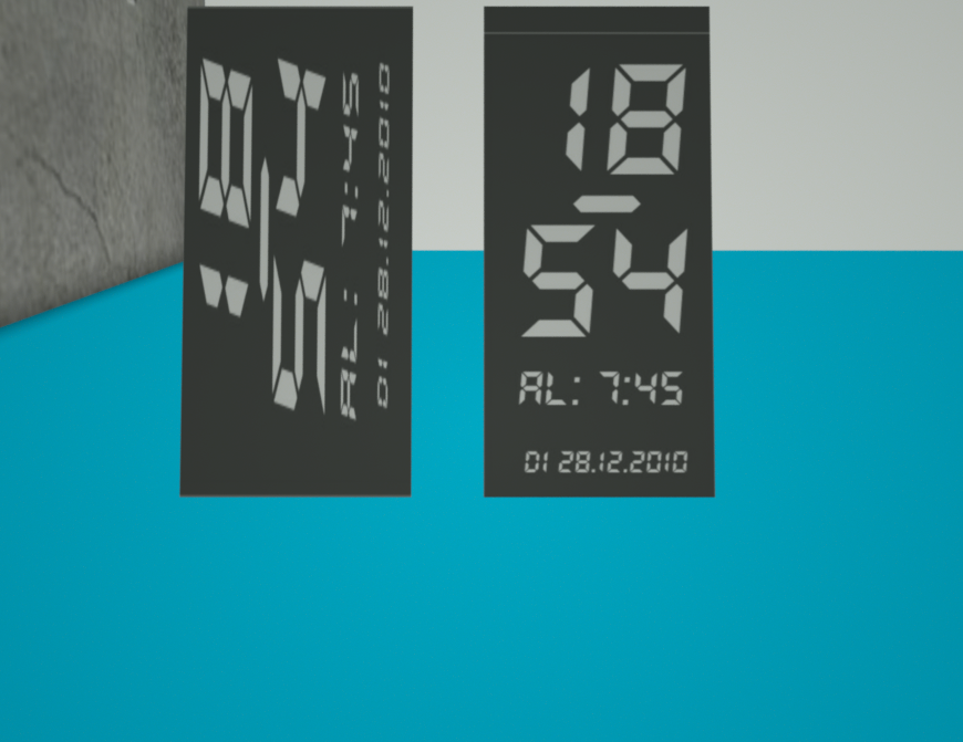

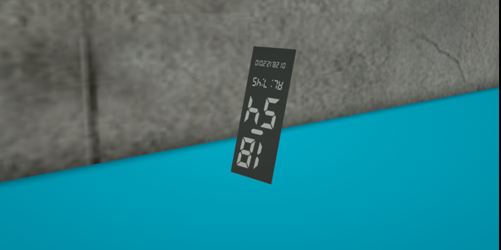

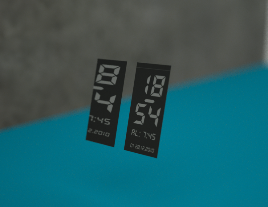

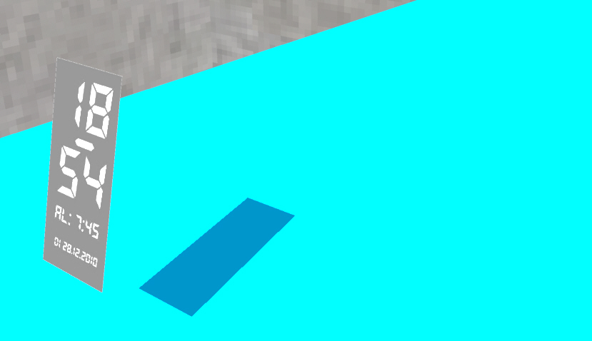

Ah ha. Your mapping is set to surface and you are importing into Octane Z up, so the texture is getting rotated.
The exporter (available in Board index » Licensed Customer Forums » Plugin Discussion/Support » Rhinoceros 3D) should help resolve this issue as it will remap to Y up, if you are using the exporter and it is still coming in Z up, please let me know.
You can also change your mapping type from Surface to Planar to resolve this as well. I have attached your file as it comes into Rhino for me (last image). Your original clock face is on the left, I copied it and changed the mapping from Surface to Planar on the face on the right. The second image is the result from Octane using the exporter, the first is from just an OBJ export with Z up in Octane.
Sam
In Octane when exporting with Z up
In Octane using the exporter
As it looks in Rhino
