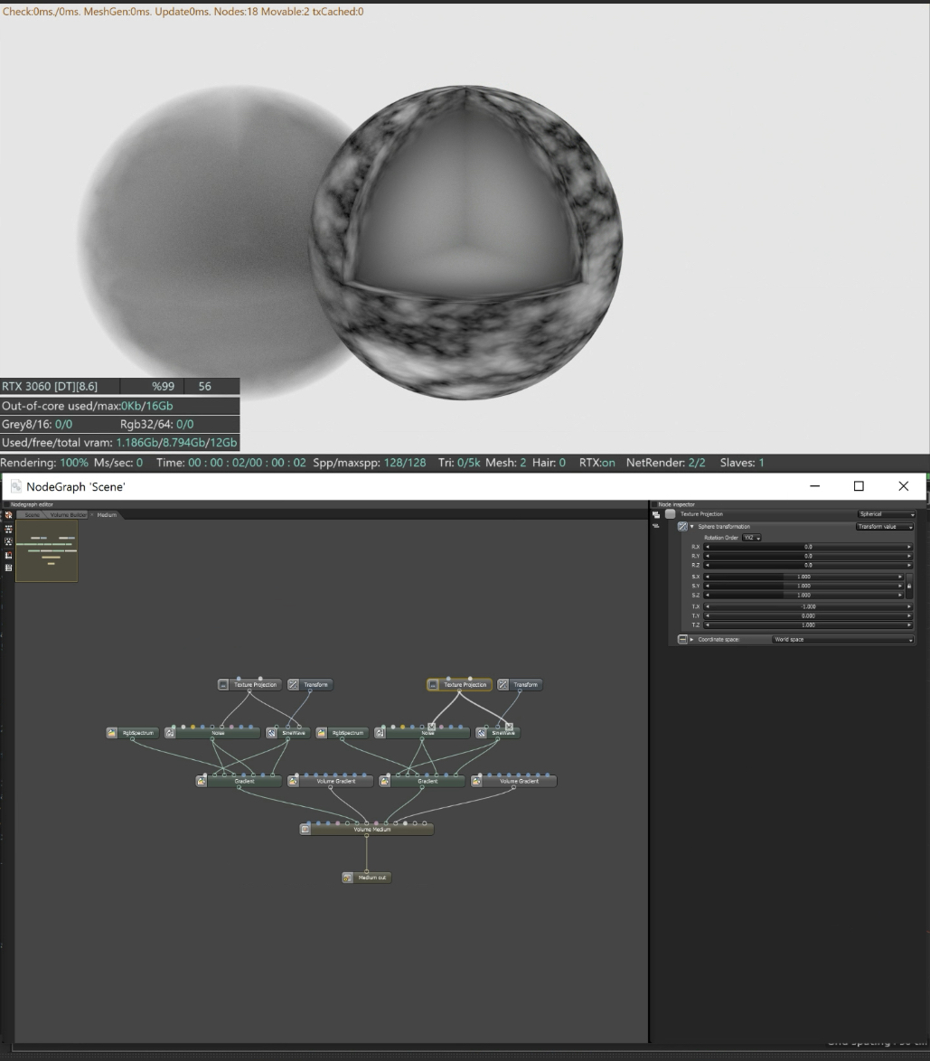

Octane procedural texture nodes are working in 3D space, so you can use them in Absorption/Scattering to change the density of Volumes:
About Texture Displacement at 16k, please consider the VRAM consumption.
