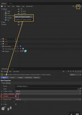

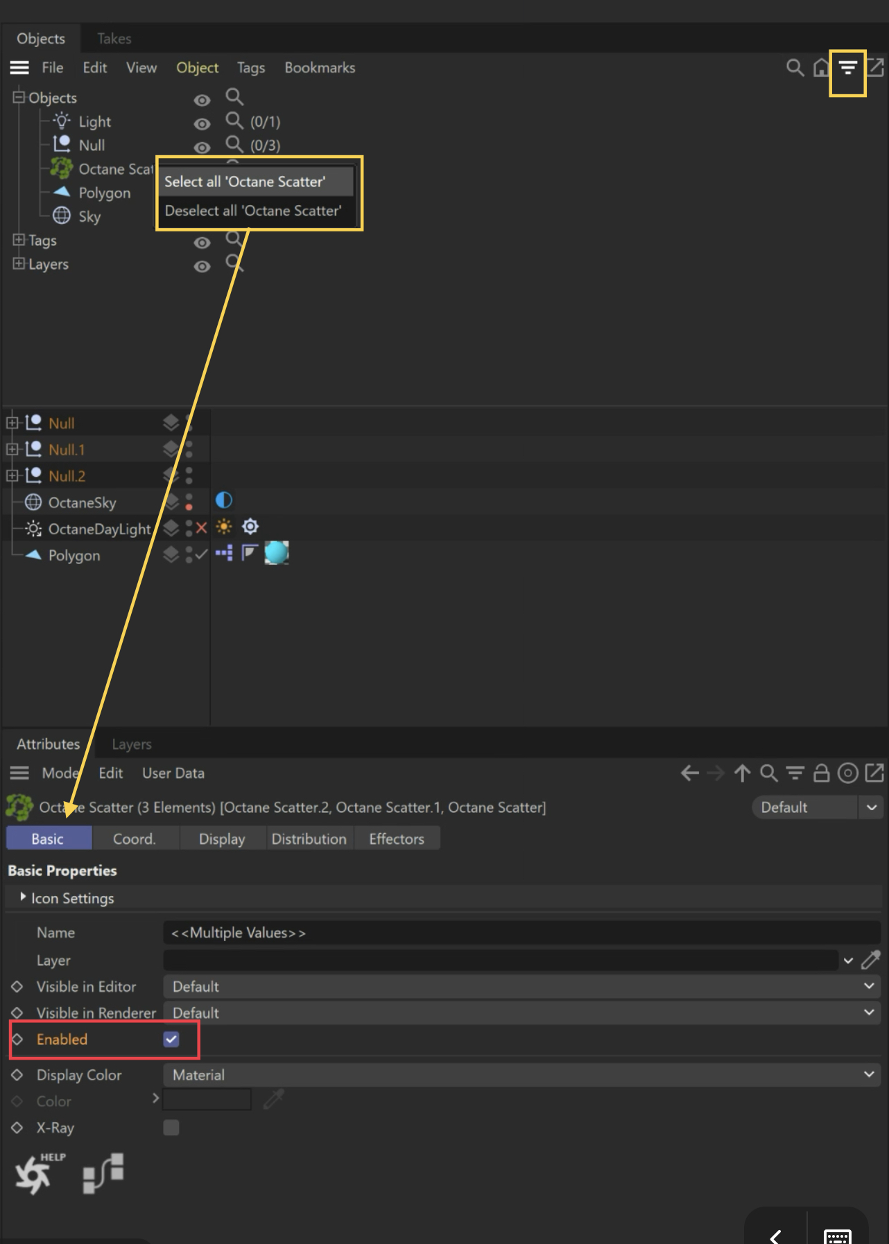

you can do it in c4d object manager + attribute editor with a couple of clicks:

Ciao Beppe,
thank you so much, we didn't think about this quick workaround!!

you could make that enabled button part of an extra take inside the take manager, which is dedicated just for preview rendering so you dont have to think about it all the time.
This is how we do it.
