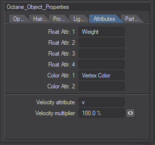

juanjgon
Posts: 8867
Location: Spain
If the alembic has a velocity "v" attribute, you can use it to render the motion blur.
Thanks,
-Juanjo

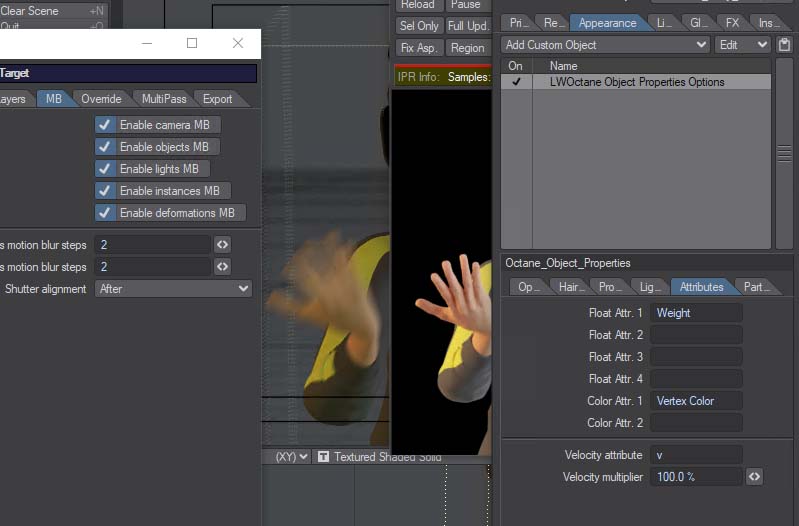

videa
Posts: 3
Joined: Thu Apr 20, 2017 8:52 am
Hi Juanjo, yes the alembic should have velocity data (motion blur renders fine in LW internal render and if I bake the scene and render it in Octane standalone render).
I have added the Octane_object_Properties to the object (didn't know you needed to do that) but it still doesn't render motion blur.
Is there something else I need to do?
I have the same problem with MDD files.

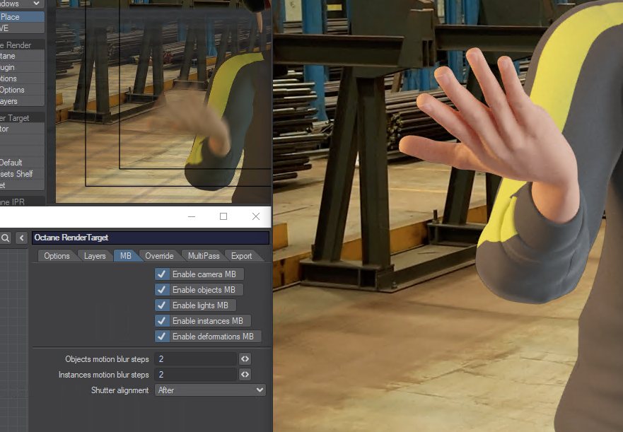

KVNOODLES
Posts: 85
Joined: Mon May 18, 2015 11:02 am
Location: Paris
Make sure you've check the Photoreal MoBlur in Lightwave...(LW2015)
Normally, with a true render (F9 or F10) you should have the motionblur visible.
IPR don't render deformation MoBlur. (Only the camera, translation, scale and rotation are supported.)
