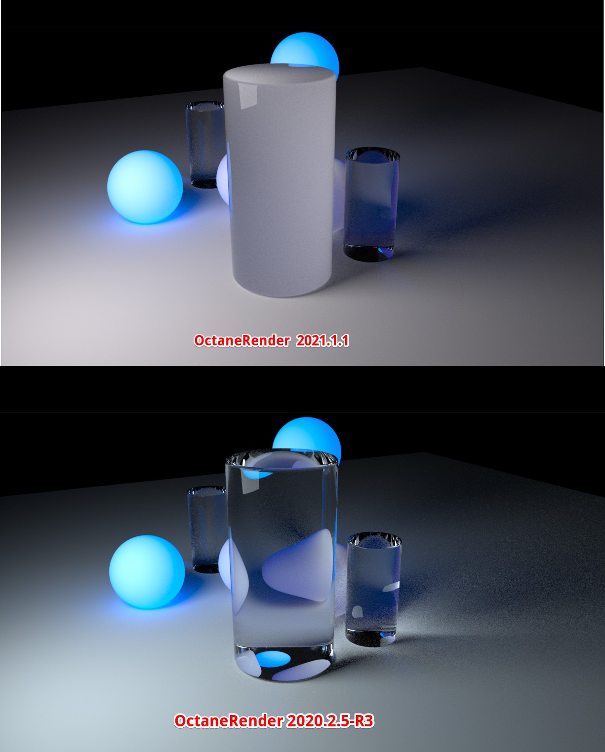

Here is the screenshot with different render results but scene is the same. Can someone explain what happens?
Or it is all known issue and i just missed something?
Here is the link to test scene, check this one and you're get different results using universal shader!
https://www.dropbox.com/s/0x4j46bg5jl51ty/test.c4d?dl=0

elsksa wrote:Hi,
I would not suspect an issue, from what I see from the screenshots. Eventually different material properties/attributes. On the glass cylinder, the roughness seems to differ.
Could you screenshot both Universal Material properties, respectively?
this is the same scene with all the same properties and different results, you can download this test project and check it

Im having the same issue with all my old projects that im trying with the new octane now
I've used Universal Material for everything, even for glass.
It used toe be as easy as "unchecking" Albedo and getting rid of Metallic reflection and voila, the Universal Material acted like a specular.
But not anymore.
Now you have to really use a Specular material.
Is that on purpose?
Posts: 10611
to fix the issue, please go to Universal material/Transmission channel, and change the type to Specular instead of Diffuse.
In previous versions,Specular was the default type, but there was an issue with Mix Material Diffuse+Glossy conversion to Universal, for leaves and similar translucent flat objects:
viewtopic.php?f=85&t=78663&p=406664&hil ... se#p406664
So has been set to Diffuse, and you need to set the type to Specular, if the Universal material has to behave like a Specular material.
