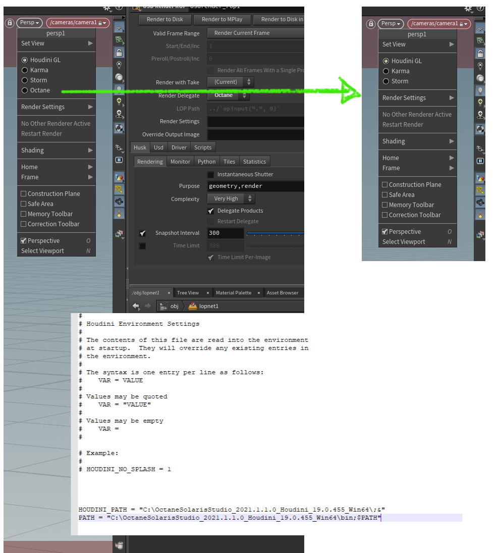

Hi Guys,
Could someone let me know how to make a basic setup using octane and solaris?? Octane seems to start ok but but when i try to activate it, it just vanish from the menu. Might it be an install issue?? Octane Standealone is working so it shouldn't be a liscense server issue, Maybe a bad install path or me not setting it up correctly for solaris ??? (I had not trouble with the regular houdini plug)

Hi BK
Yes still no luck using it.
Liscence isn't the trouble It's all good.
I tried removing the \ but still not working. I install the regular houdini plug, this one is running fine.
Look solaris plugin is loading correctly but crash only when i try to activate the viewport render, so maybe it could work with a scene properly setuped? Could you provide me one?

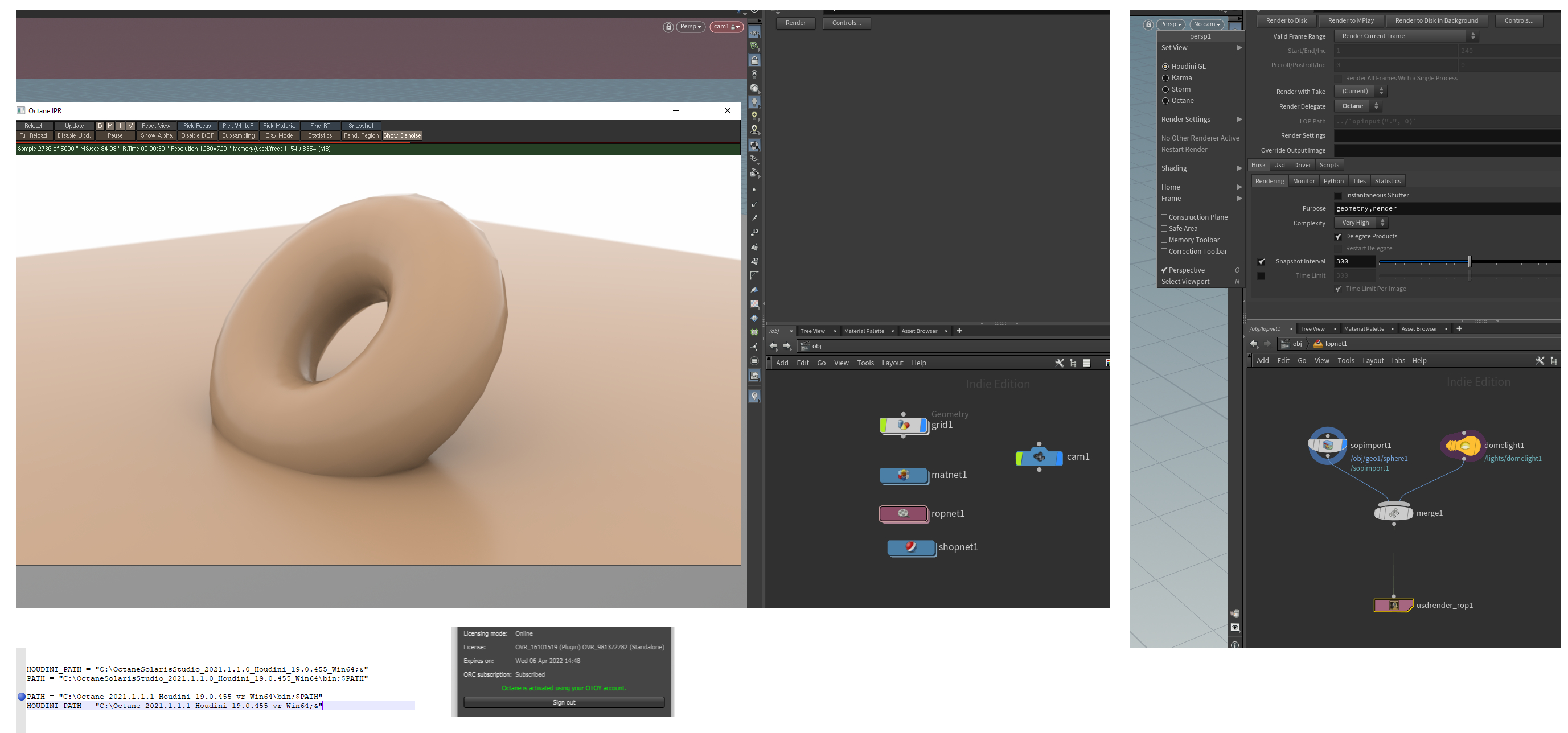

Hi canderled,canderled wrote:Hi BK
That's so bad , I really want to use this solaris/USD workflow.
Strange! Maybe it's because you have two paths for both OctaneSolaris and our main Octane Houdini plugin.
Octane Solaris is already merged with our main plugin so we do not need to reinstall/path the main plugin.
Please remove the Octane Houdini plugin path and try again!
If it does not work then please send an email via our support [email protected] for further investigation?

I have the seem problem too! I just installed solaris plugin by json file, I works well in SOP IPR render, but in solaris, I can't activate persp - octane button, if I do that, the button just disapeared. And can't find that again unless restart houdini. Also, octane can't render in solaris viewport and render rop node.

It would be really great to have a octane solaris scene by otoy that is perfectly setup to learn.
