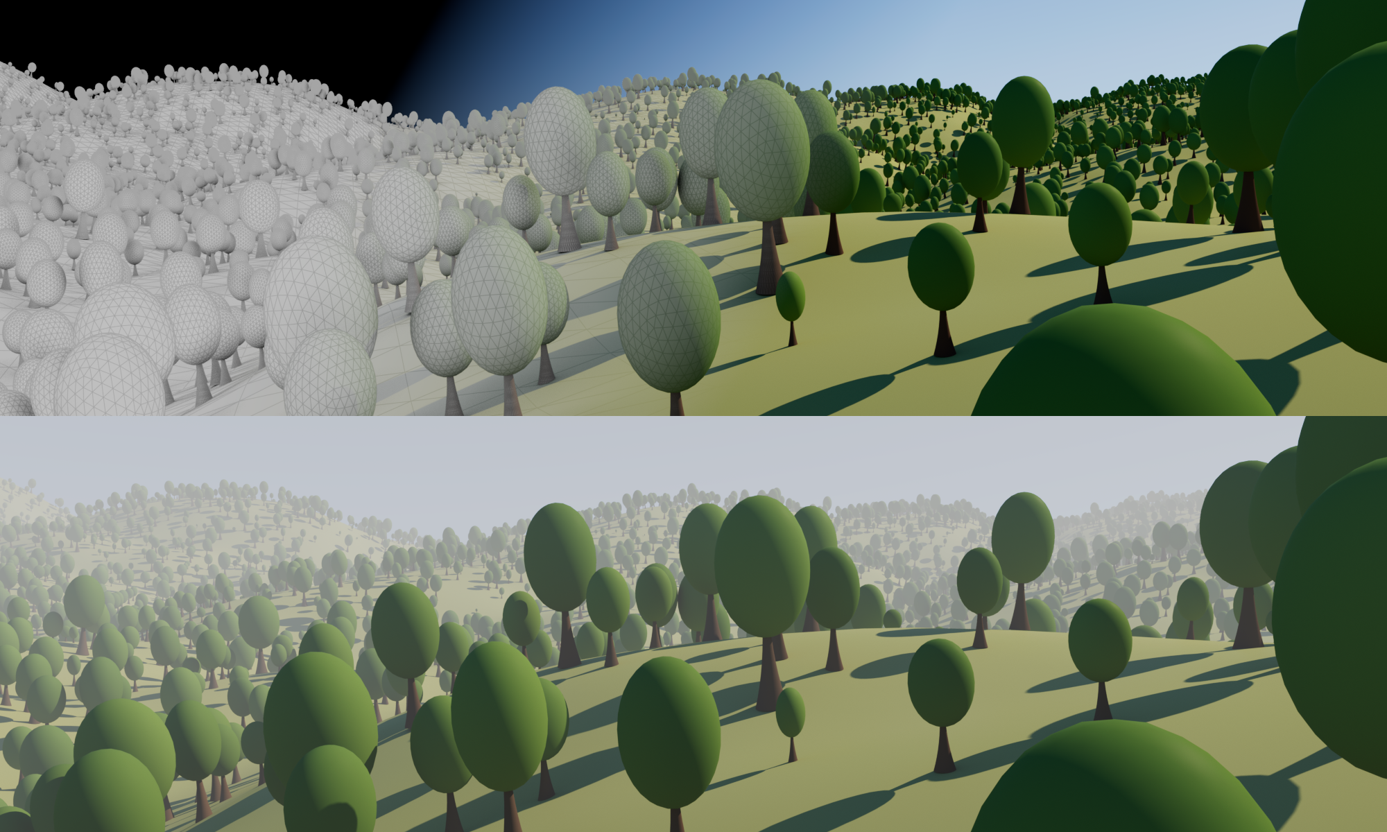

AOV Composite Example
The images below are the result of three contributing Global Texture AOVs, used to build up the wireframe blend on the first image, and the depth fog on the second image.

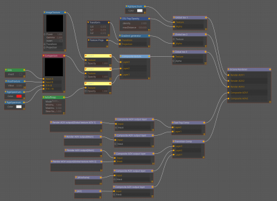

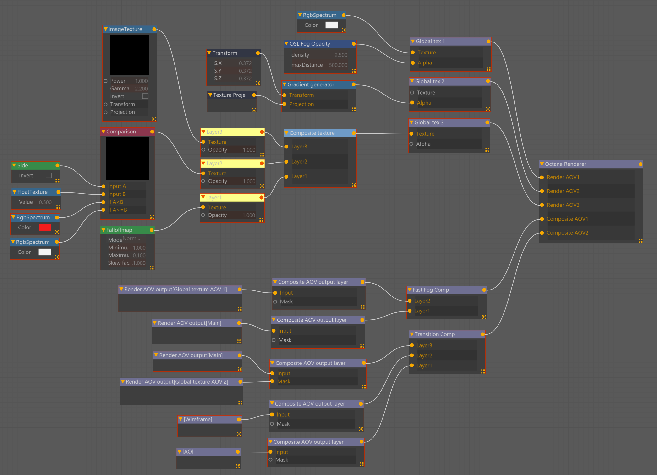

The illustration below shows the node graph for the composite images above directly from Octane:
Each of the Global Texture AOVs have standard material nodes as inputs. These subgraphs are used to build up the effects that are then blended into the Render Pass AOVs connected into the Composite AOV Output Layer nodes and then into the Composite AOV Output nodes. These nodes are connected to the Composite AOV pins of the Octane Renderer node for final output.
