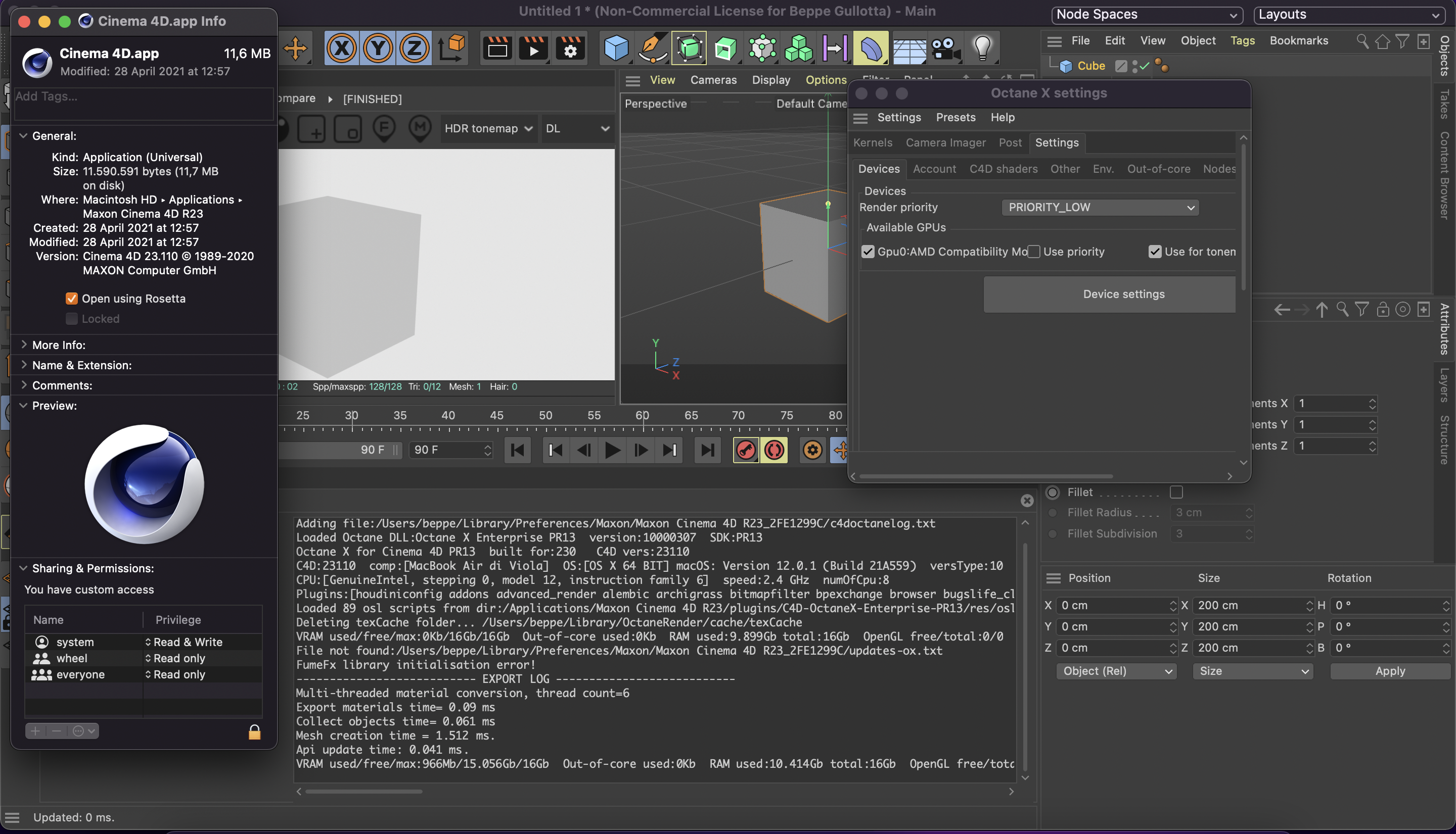

is the PR13 also only for Cinema running in Rosetta?
Posts: 10656
Yes, if your mac is equipped with an M1 chip, you need to select the Cinema 4D.app, press Command+I, to get the Info panel, and enable the Open using Rosetta option:

Did anyone get this to work on an M1 mini.
My Octane C4D plugin doesn't even show up. And if I set C4D R25 to open in Rosetta, some X-particles Lib makes it crash.
That's quite a shit show since standalone works on the mini.

About M1 and Rosetta, unfortunately you need to have two copies of C4D, one with Rosetta active for Octane, and any other non native plugin, and another C4D version for native plugins like X-Particles.
2022.1 SDK is in alpha stage, so difficult to have an ETA on when M1 native will be available... as soon as possible!
