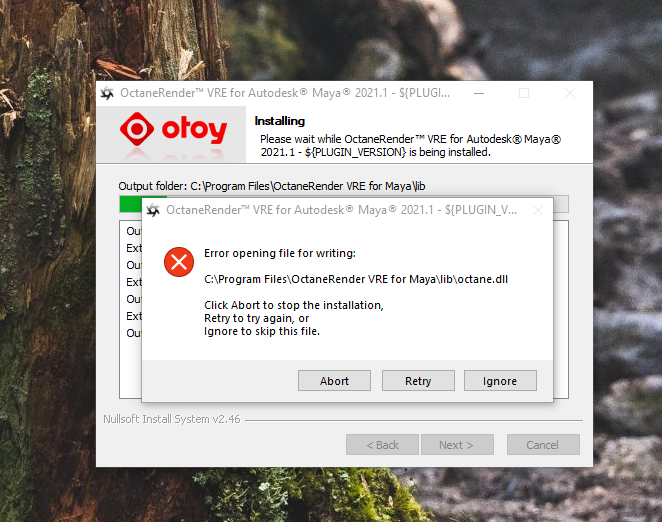

I just tried to install this version and got this error.
Windows 10
Maya 2024.2
2 RTX 4090s 192 gb ram

Weird. I can't reproduce it on my side, works OK...
I will investigate it further and release a quick-fix if there is some issue on a plugin side...

I rebooted my computer and tried again and it works, so false alarm.
