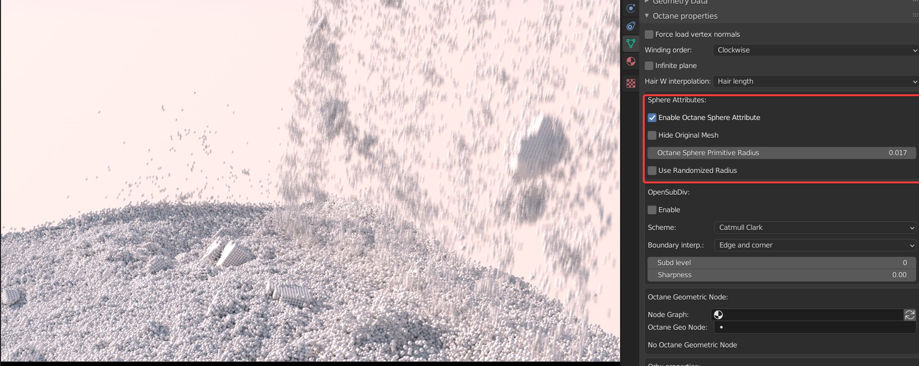

This is blender octane, octane sphere primitives rendering with motion blur on alembic particle file.
Can such an option be added to Octane c4d?
