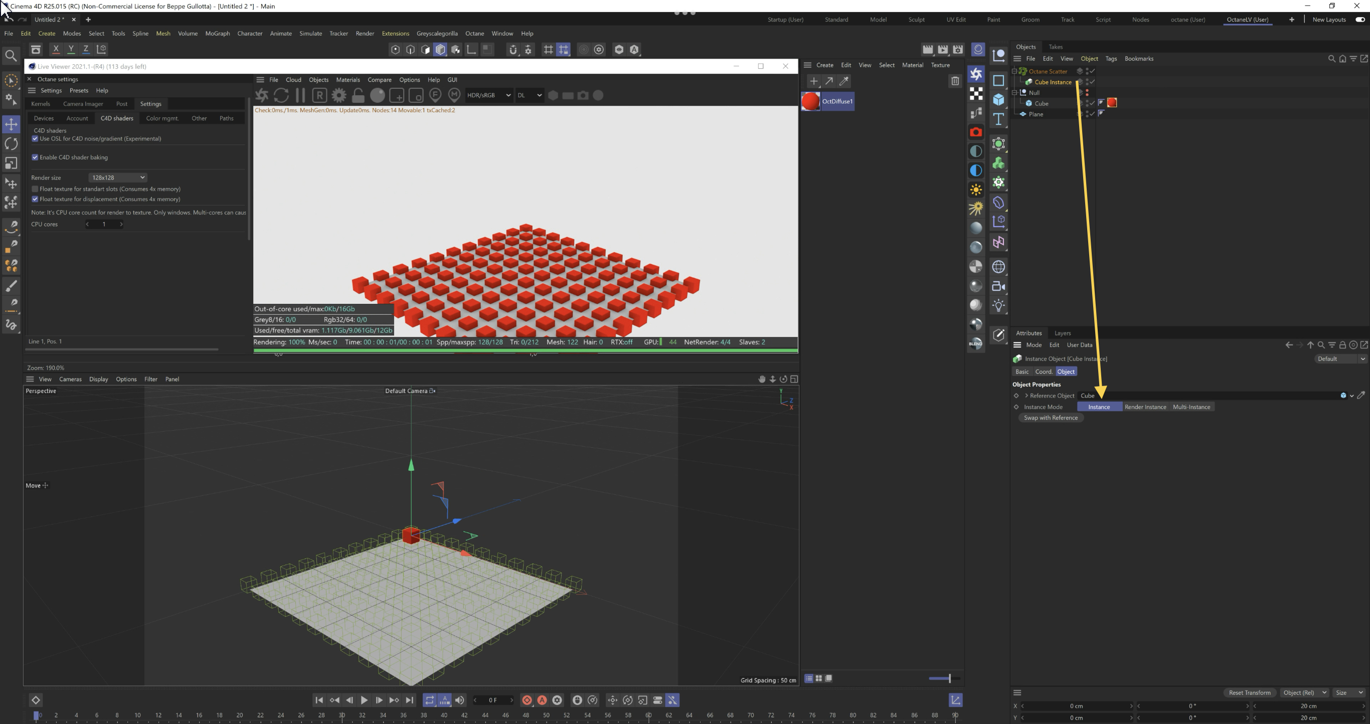

you could hide the objects to scatter in a Null with red traffic-lights, then use an instance of the objects as source for the Octane Scatter:
Note that the Instance object must be set to Instance mode, Render Instance or Multi Instance modes are not working in this case.
