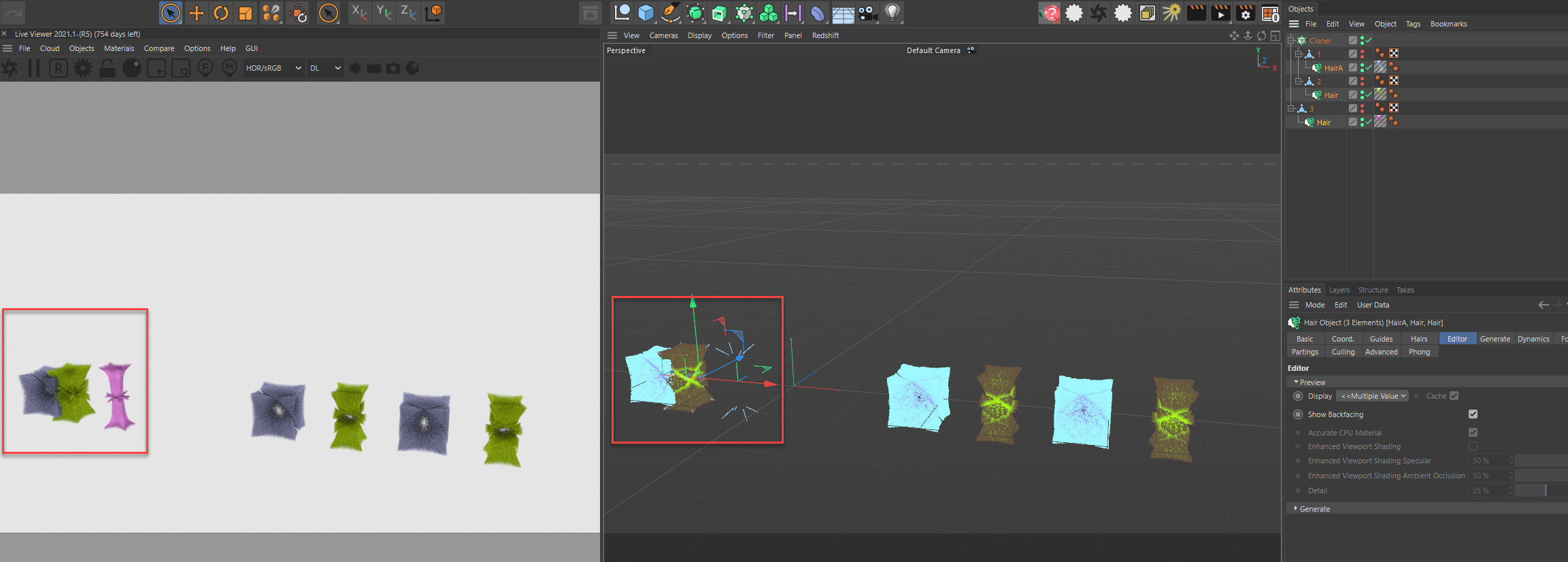

I am using C4D R23 with Octane, I have multiple objects inside a cloner with hair applied to each of them. The cloner is set as Linear and set to only show 1 object at a time.
When viewed through the Octane Live Viewer I can see all hair modules erroneously displayed at once, when there is actually only 1 visible in the C4D viewport.
If I change all hair modules to Generate > Circle then only 1 module is visible but with all colour removed.
If I convert all hair modules to an Object and delete all the original hair then only 1 module is visible. I woud ideally retain all original hair splines though.
I've attached a sample project file to better explain the issue.
If anyone has any ideas on how to overcome this, they'd be very welcome! I have a deadline fast approaching and can't move forward until this is resolved.
Thanks, any advice appreciated.

Are you talking about the hairs which are not be visible in to render as marked?

Yes, so if the cloner offset was set to '0' it would ideally only show the hairs and object from Group 1.
It shows the correct geometry and hairs in the viewport, but not in the live viewer.

But it's collecting the source data as you can see. It's not working as other type of objects since we haven't thought to assume somebody would to use it like this.

Ok, no problem. I just realised I can set the Generate Type to 'Circle' and then apply an Octane Hair Material to it to add the colour back in, whilst using the original hair material to style the hair with thickness, kink & scale.

Ok but then it will not a Octane hair type, will be geometry. Be carreful to don't avoid to explode the renderer with a lot of triangles. Btw I'm fixing the issue for 2021.1 build, you can get a test build if you wish.
