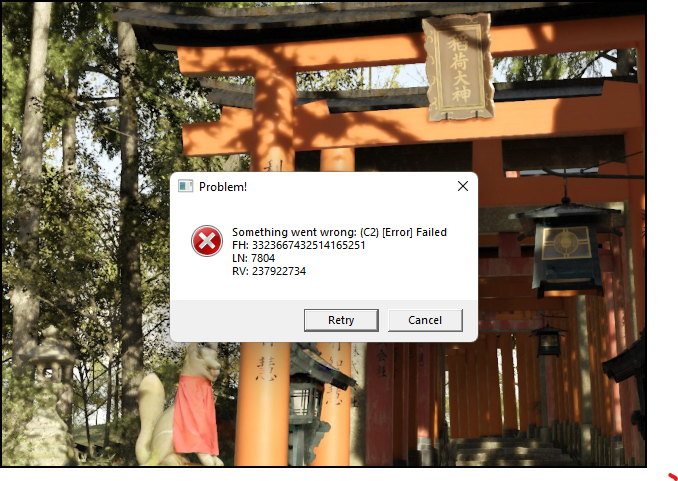

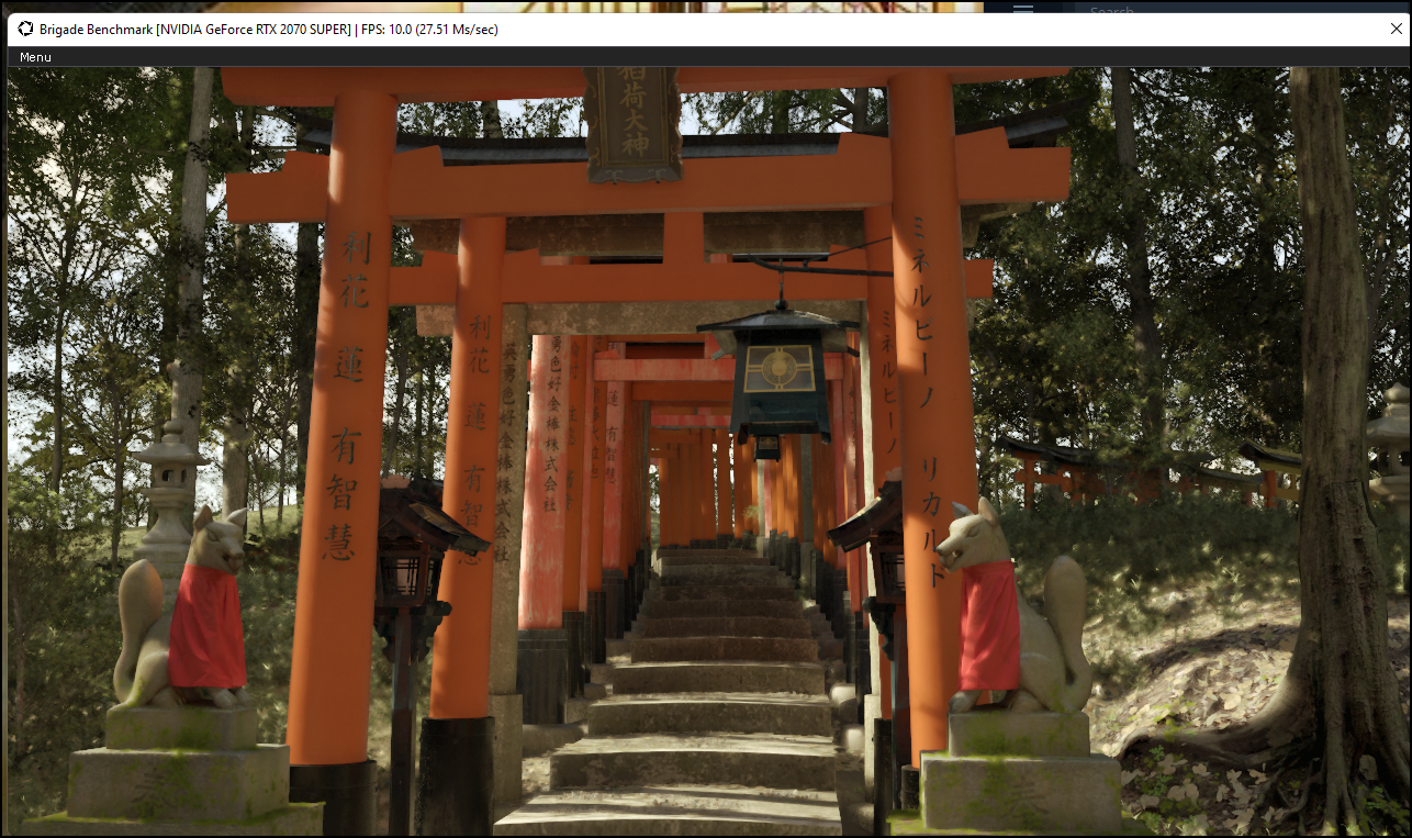

Question. of "current" expectations... i'm running brigadebench and did the 1280x720 just fine. but ONLY at 10fps.. is that normal for say a 2070 super? also... the 1080 version just crashes with an error over and over with various addresses is this a GPU Ram issue mabye?
See attachments..
latest nvidia drivers. latest updated win11
See attachments..
