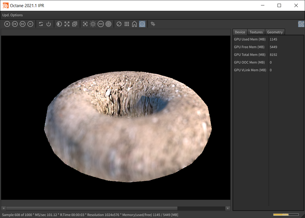

luminouspowerhouse wrote:Checking the forum everyday in hopes to see new ipr for Houdini implemented. Any ETA, Juanjo? Thank you!
It's coming ;) I want to release the first plugin build including a beta of the Qt5 IPR with all the functions available in the current OpenGL IPR before the end of the year.
Thanks,
-Juanjo
Thanks,
-Juanjo
Finally :P
luminouspowerhouse
Posts: 33
Joined: Thu Nov 20, 2014 3:20 am
Exciting!!! Juanjo thank you for sharing the teaser image! Very much looking forward to it!!!
