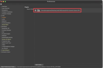

If you are using C4D R20/R21/S22/R23/S24/R25, you need to create the **plugins** folder inside the c4d directory, in lower case.
Please avoid to load the c4doctane folder from c4d menu Edit/Preferences/Plugins panel, or you will have a conflict:
Note that you always need to remove from the c4doctane folder, all the unnecessary c4doctane-RXX.cdl64/xdlib files not related with S24 specific versions, and leave only one c4doctane-S24.xdlib file in Program files/Maxon/C4D R24/plugins/c4doctane directory.
