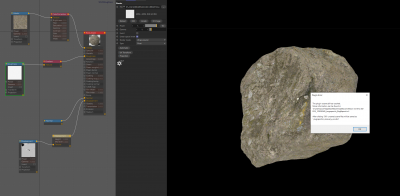

hey Ahmet,
here is a screengrab of the crash.
So that was just me opening the project, soloing one node (Octane gradient node) and undo the solo (with the D hotkey).
And boom, crash.
And I attached the bug report as well
y
octanelog_report.zip
Here is the bug report
(167.08 KiB) Downloaded 157 times
screengrab
screengrab

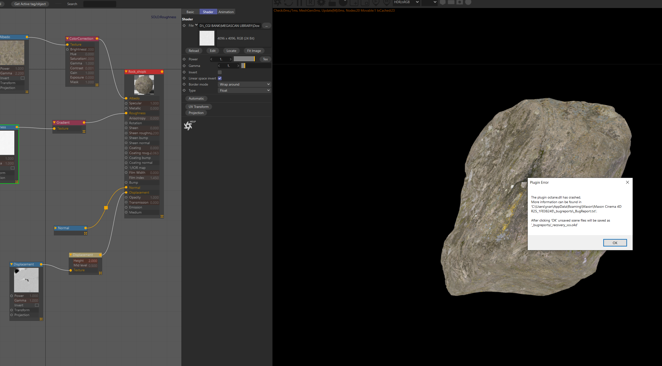

and another one...
exactly the same, this one actually was solo on the texture node linked to the roughness.
EDIT : just a note, I got the latest C4D R25 / Octane / Nvidia Drivers
but it does the same in C4D R24 as well
