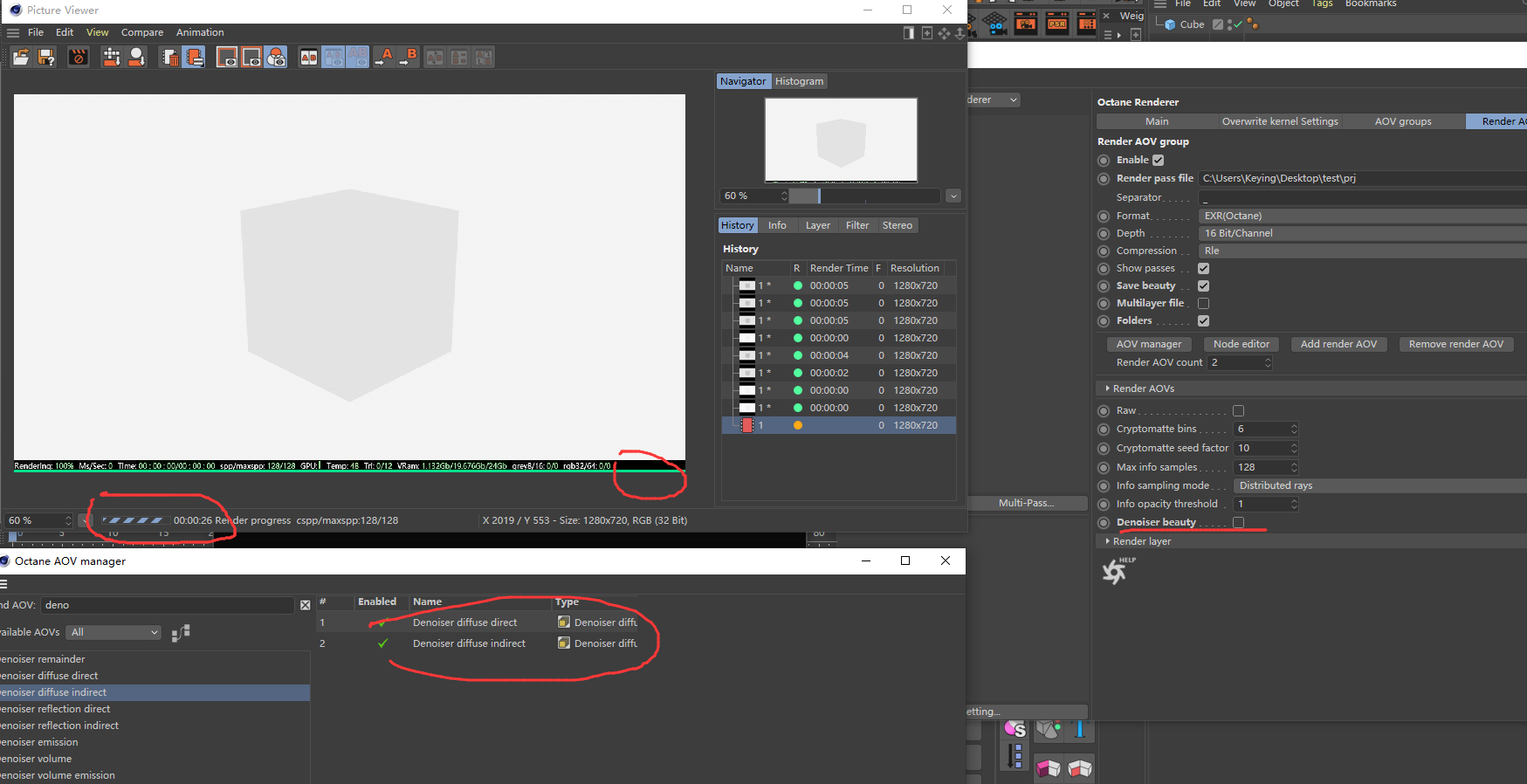

I have a problem. When Denoise AOV is selected, if Denoise beauty is not turned on, the rendering time will never stop.

blackcat321 wrote:I have a problem. When Denoise AOV is selected, if Denoise beauty is not turned on, the rendering time will never stop.
Denoiser device and denoising should be activated for work-around. Plugin try to detect and do this for you, but seems like doesn't in case. Use your magic for now.
