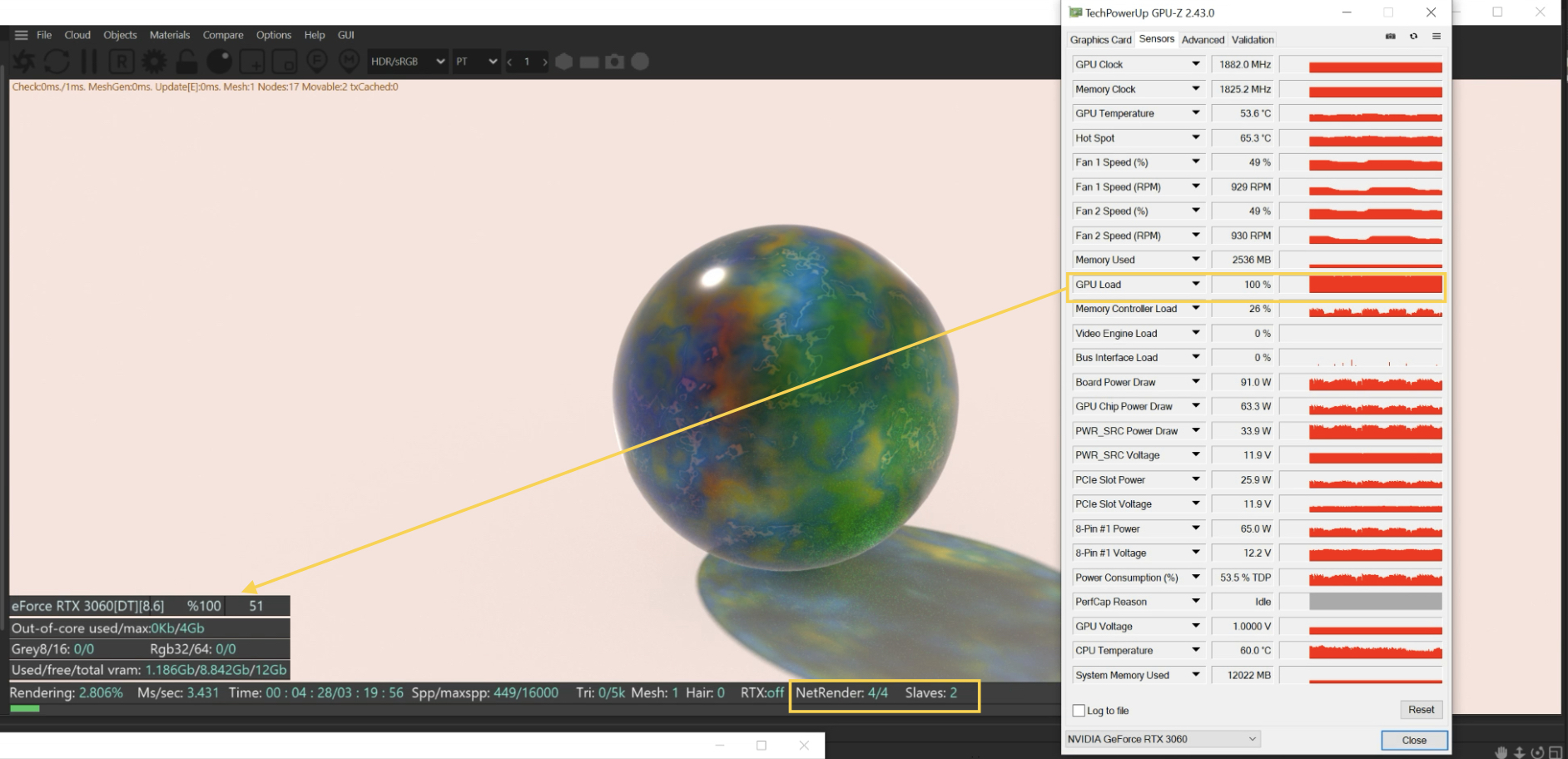

Network Render cannot work without the "Master GPUs", they are the primary GPUs, the scene firstly is loaded on them, then on the Network GPUs.
Please use GPU-Z for monitoring the "Master GPUs" sensors while Network rendering, and in particular, GPU Load, Temperature, and Power Consumption-TDP.

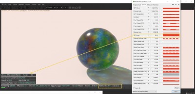

you can check the GPU usage in Live View, and with GPU-Z Sensors tab, please share a screenshot like this: ciao,
Beppe
