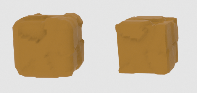

I get this when enabling the invert node on the yellow object.

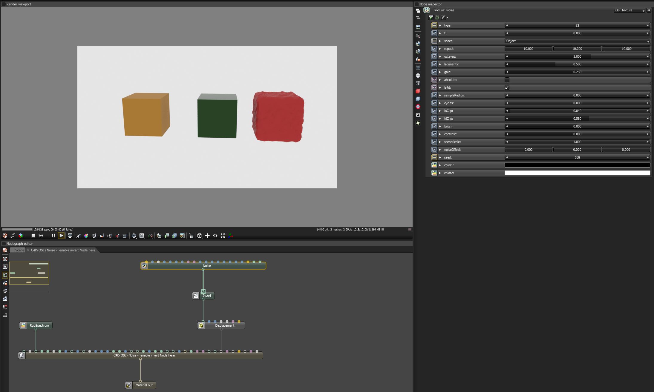

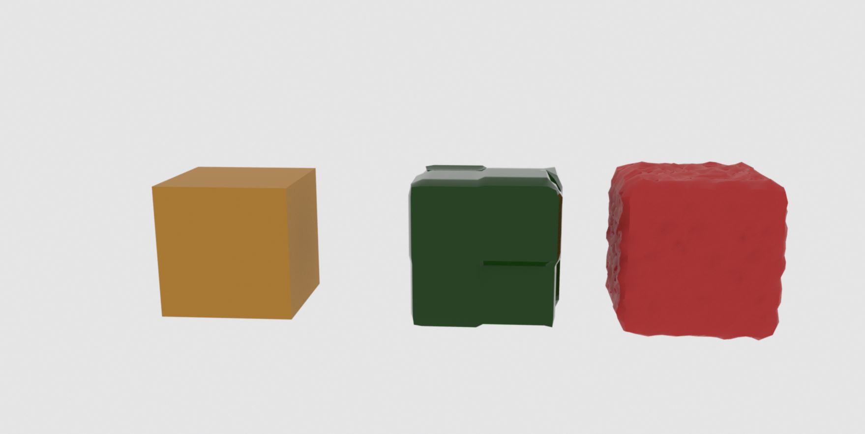

Hy, i use C4D and Plugin. Never used Standalone. Plugin 2020.2.5-R3 Studio Driver 461.72 C4D R25.015
If i enable invert Node, displacement on the yellow cube is gone.
If i now send the Scene and restart new render, displacement on the green cube is also gone without any changes on that green material.
Happens on two different machines with the same Software config. maybe i do a screencapture later if you couldn´t reproduce it.
The red cube is an octane noise for verification that this could be an OSL Problem.

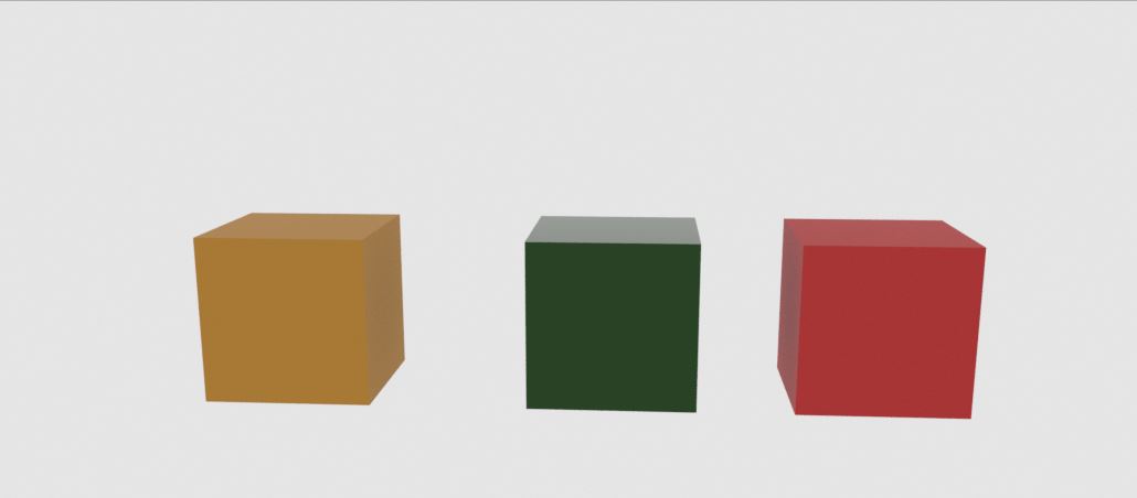

i tried today the standalone version. After opnening nothing works. the c4d node is now an OSL node. if i change this osl node to c4d noise it will work.

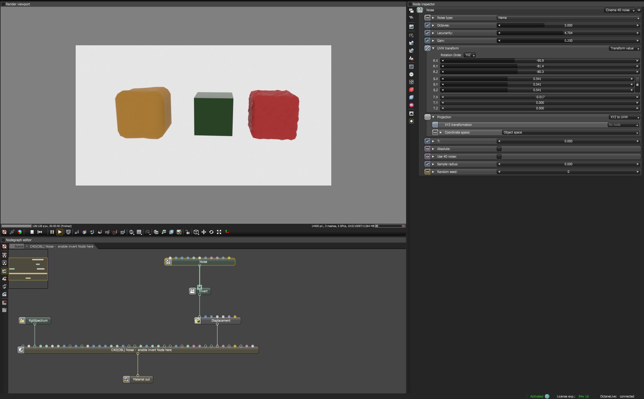

2020.1 C4D R25 makes it more worse. now the octane noise fucks up too.
Enable invert node and resend the scene. could you please confirm a bug or a user error?
