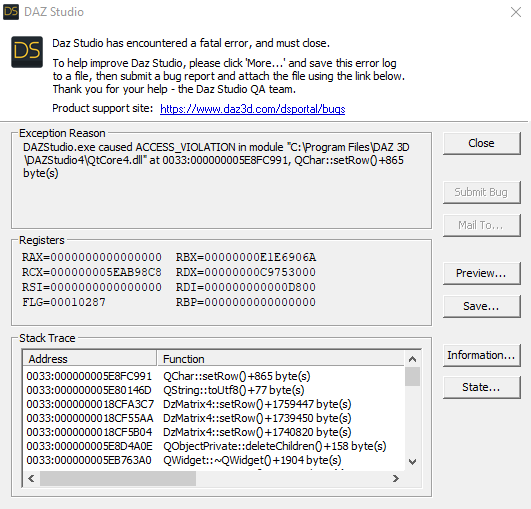

After upgrading to 2020.2.17.60 a few weeks ago, if I open the OctaneRender Image Browser, on Selecting an Image, clicking Cancel or pressing Esc, Daz Studio crashes with the following error:
The work around is obviously not to use it, but I have 6+ years worth of always clicking it to select or view images built up and it's a hard habit to break. I've lost hours of work over the last few weeks due to either clicking on the ... button out of habit or missing clicking it by mistake.
I've attached a zip with the error log and crashdump saved from the above crash message.

hi SiliconAya,SiliconAya wrote:After upgrading to 2020.2.17.60 a few weeks ago, if I open the OctaneRender Image Browser, on Selecting an Image, clicking Cancel or pressing Esc, Daz Studio crashes with the following error: The work around is obviously not to use it, but I have 6+ years worth of always clicking it to select or view images built up and it's a hard habit to break. I've lost hours of work over the last few weeks due to either clicking on the ... button out of habit or missing clicking it by mistake.
thank you for sharing the crash dump file.
Would you please try the 2020.2.16.61 build from yesterday while we try to replicate it?

Hi Sudisk,sudisk wrote:Hey BK,
I can confirm the crash on the latest beta.
Regards
Thank you so much for the confirmation!
Would you please try in a different folder with fewer images?
We are still unable to replicate this issue. Wonder if anyone is having this same issue!

Hello BK,BK wrote:Hi Sudisk,sudisk wrote:Hey BK,
Regards
Cheers
I tried with a single image folder, and I got the same result. I did the attempt with a single cube in the scene.
Could there be other parameters, like a long folder history, or multiple DAZ libraries, be the trigger ?
Regards.
Thanks so much for the update Sudisk,sudisk wrote:Hello BK,BK wrote:Hi Sudisk,sudisk wrote:Hey BK,
Regards
Cheers
Regards.
We are still unable to replicate this crash issue.
I have attached the Crash log files to our internal ticket to investigate at the code level.
