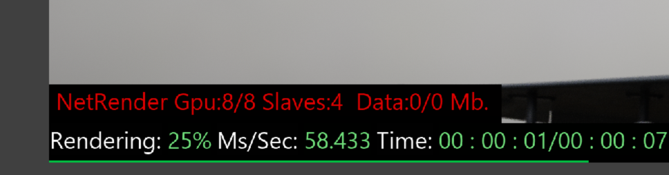

I have 1master & 4 slaves. (10G Network / Firewall Setting Ok / Same Studio Driver Version / Bind 4 Slave - Node Running)
1. Load Scene. LV NetRender is OK... LV ... LV....
2. Finished Scene Setting. after PV Net Rendering (Red Text : NetRender Gpu 8/8 Slaves:4 Data0:0Mb) -- Slave not running)
3. Shutdown C4D. reload Scene.
4. Right away PV Net Rendering. (Green Text : NetRender Gpu 8/8 Slaves:4 Data: 1377:3931Mb)
What is the problem. My scene has no any c4d shader.
Any Tips?
