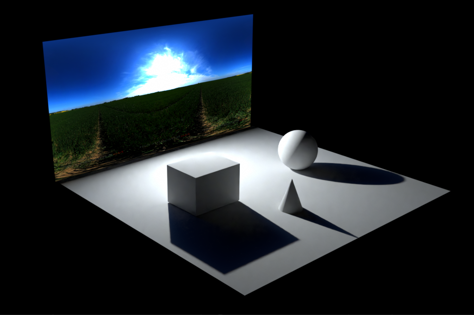

I'm not a lightwave user, but if I understand what you are trying to do, you can map your HDRI onto an Area Light and use that as your backdrop. Either that or use it as a luma map on a normal polygon. But I think there are some render optimizations in Octane that make actual Octane Light objects more efficient.
HDRI as Area Light Texture

Octane currently has this limitation which has been reported already: viewtopic.php?p=380230#p380230
frankmci wrote:you can map your HDRI onto an Area Light.
I have noticed that the "̶G̶a̶m̶m̶a̶" seems to be set to ~2.2 (sRGB approx.) instead of 1.0 (Linear Transfer Function).
