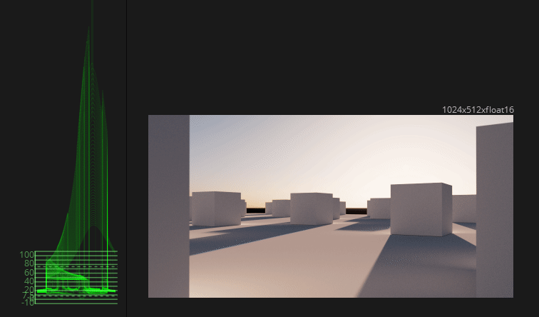

Ok, so what is difference between Filmic tone mapping and Highlight Compression in Octane Camera Imager ? In my test they both looks near the same and have the same limitations while saving to output linear file.

elsksa wrote:An other advantage of the Filmic OCIO package is that it can be applied in post and is generally speaking, "post-friendly" since it can be re-applied independently from the renderer, while Octane's Camera Imager's Hightlight Compression is limited to Octane internally and so, prevents from exporting a linear-scene-referred floating point output - in other words, the output has to be display referred as an integer file format (JPG, PNG, etc) and so, limiting what can be done in post.
The problem is that saving Filmic OCIO as 32bit EXR do nothing - it lose 32bit depth and it looks the same as saving using Highlight Compression. I compared it in Photoshop and Affinity Photo. Exporting OCIO from Cinema 4D Octane even as 32bit linear EXR flatten it to 8 bit. Maybe this is bug ? Exporting as ACES works fine.

Theoretically... but please see here, something is wrong with exporting via OCIO in Octane : viewtopic.php?f=85&t=78286&start=50#p404607

elsksa wrote: Are you exporting "HDR (Float 32-bit)" as PNG?
No ! it was saved as 32bit EXR. PNG was only PrintScreen screenshoot :)

elsksa wrote:I am a bit in a hurry and rushed it but here is a quick test.
The gif file might not auto-play automatically unless opened in a new tab or downloaded.
And do the same with Filmic OCIO - you will have 8 bit output. I've just tested it in Octane Standalone too. Standard ACES works fine.
