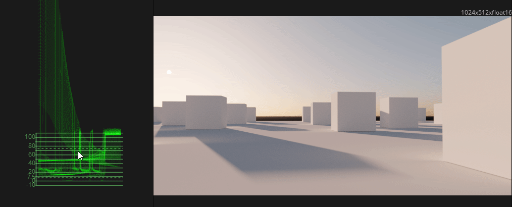

Hi SSmolak, the gif above is showing the Linear-ACEScg encoded EXR in Fusion.

• As Linear-sRGB 16-bit EXR? If yes, then it is as if there was no "Filmic" OCIO configuration file, since, again, "Filmic" is just a view transform.
• With the Filmic Log Base Encoding applied?
While I do not need to test it because as I have mentioned before, there are no OCIO or export issues with Octane that I have encountered using both ACES and Filmic OCIO color managed Octane project which both behave as expected, I did follow your demand.
Here is a test with the "Filmic" OCIO configuration file loaded. It is needless to say (as mentioned before), Octane is exporting a Linear-sRGB EXR, without the view transform applied. Filmic OCIO is then re-applied the same way, in post.
The waveform scope on the left is showing the full dynamic range 16-bit half floating point OpenEXR.
As mentioned in a previous message, it would likely be an end-user clumsiness or it might potentially be caused or related to the MacOS-specific HDR color management.
Credits: OTOY Inc.
Credits: OTOY Inc.
I do not have a Mac laptop/computer as of now and so, can not easily verify myself, however, this MacOS specific option should not affect export but instead, the frame buffer preview.
Last but not least, it could be an issue related to the compiled version of Octane for MacOS (Octane X) but I would doubt that, as we would have seen more reports from other members, including some active Octane X users I know.
Looking forward to receiving more information about your MacOS HDR support settings in Octane and how you are viewing and/or compositing in post.
