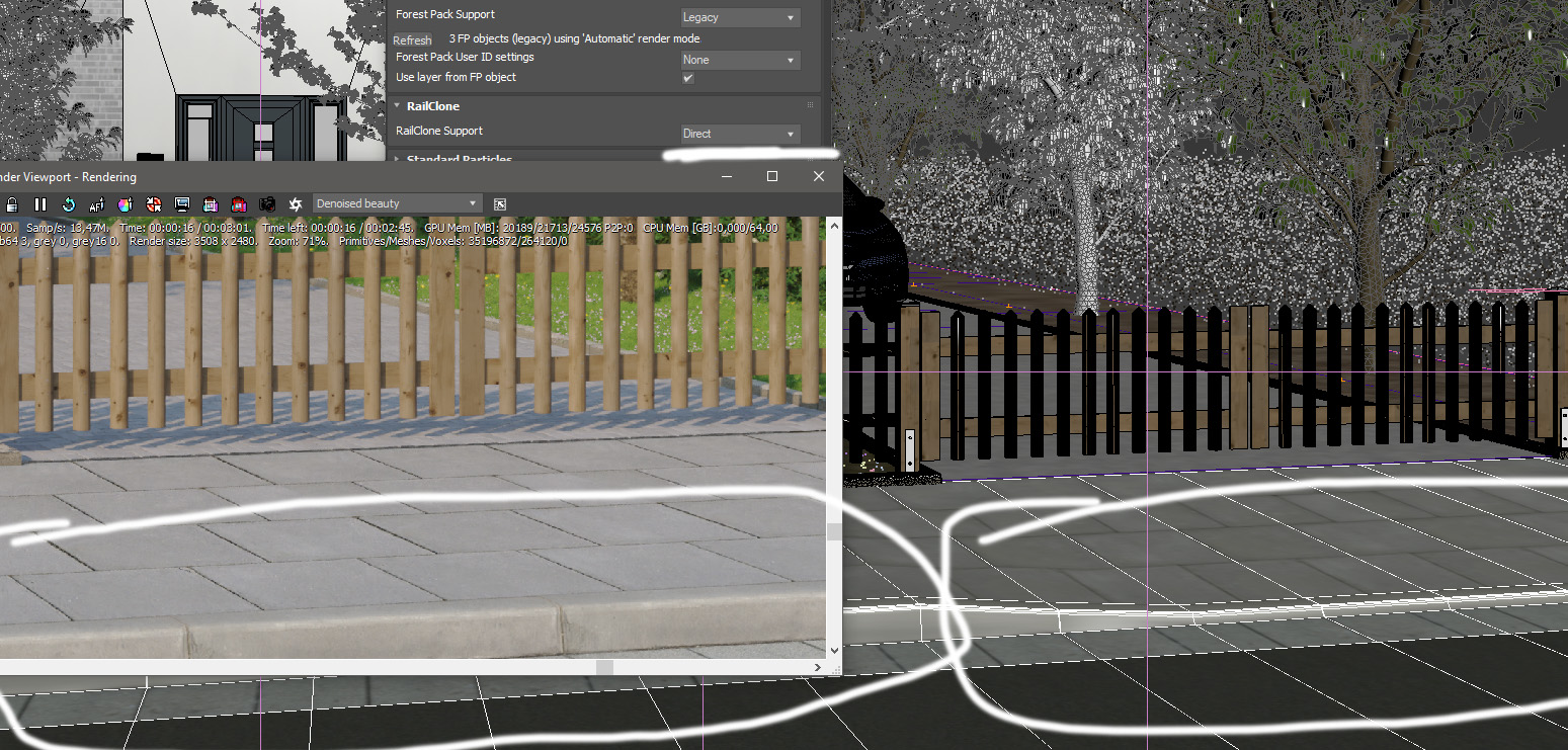

When I use Direct Support with Railclone (latest version) it doesn't consider the changes I made to the mesh. I put an edit poly modifier on top of it to lower the curbs.
As soon as I switch to Standard Support, it works.

Hi mbetke,mbetke wrote:When I use Direct Support with Railclone (latest version) it doesn't consider the changes I made to the mesh. I put an edit poly modifier on top of it to lower the curbs.
I could reproduce this issue. This will be fixed in the next release.
A work around for current version is to use Rebuild Scene after a mesh is changed..
