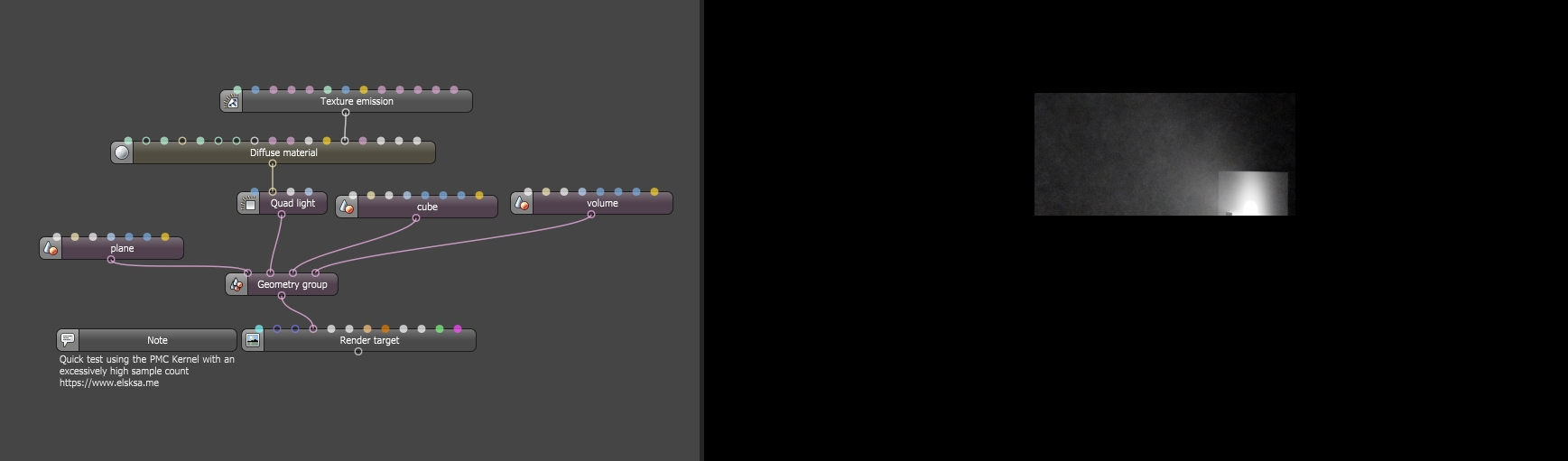

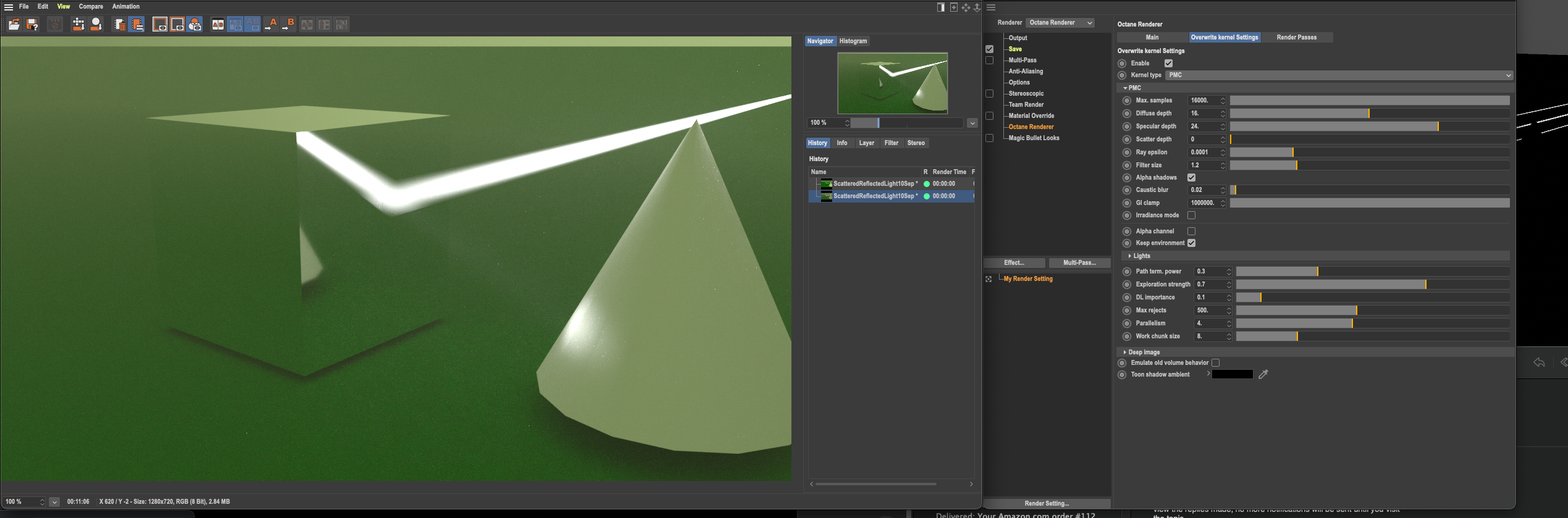

Thanks Elsksa!
I have been able to create the effect using OctaneX Enterprise for C4D (PR11 for MacOS Big Sur (Metal))
The effect isn't as dramatic as I had hoped. And, as you say, compute intensive. It is hard to see the effect in the attached image but I can see it on my system. Very faint scattering from the cube to the cone.
No Volume: With Volume:
