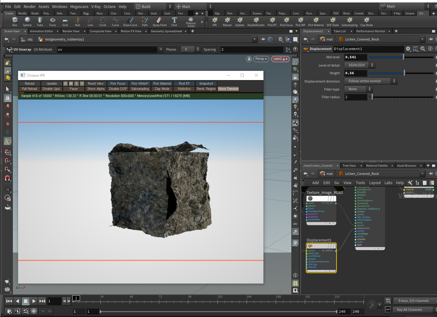

The displacement creates the gaps between the UV seams whereas I want them to be fused. Is there anything that helps get this around?
Houdini 18.5 Octane 2020.2.5.0

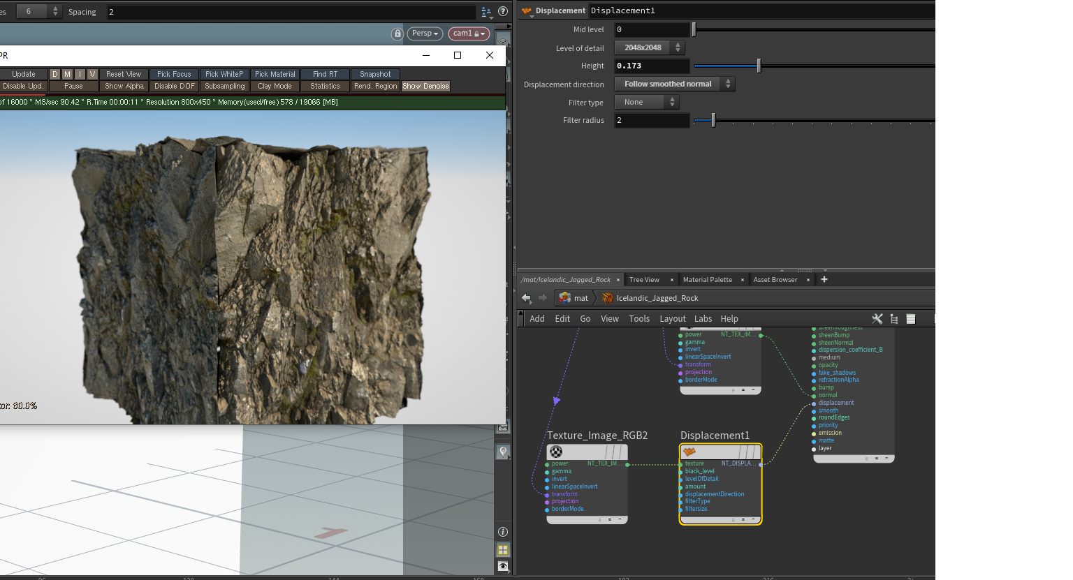

The "issue" faced is rather modeling than Octane related. Having beveled edges to the geometry primitive and appropriate normals, should yield the expected result.
