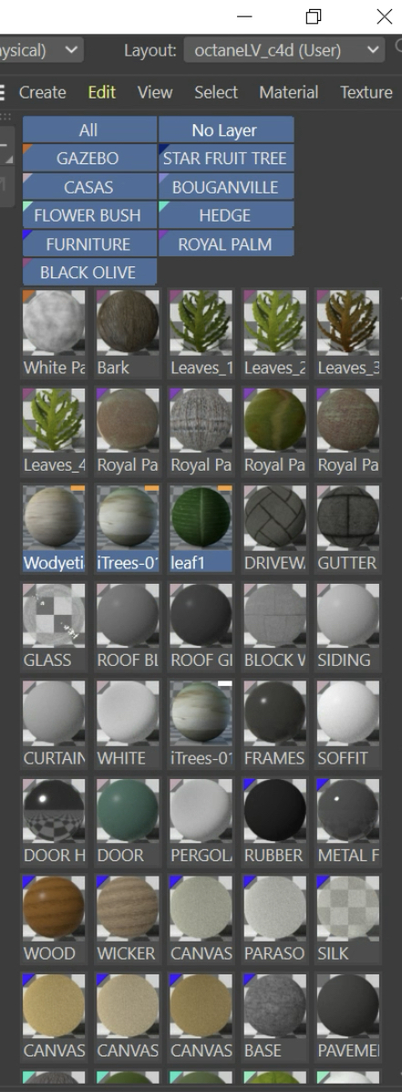

First of all, you have some c4d materials in the scene:

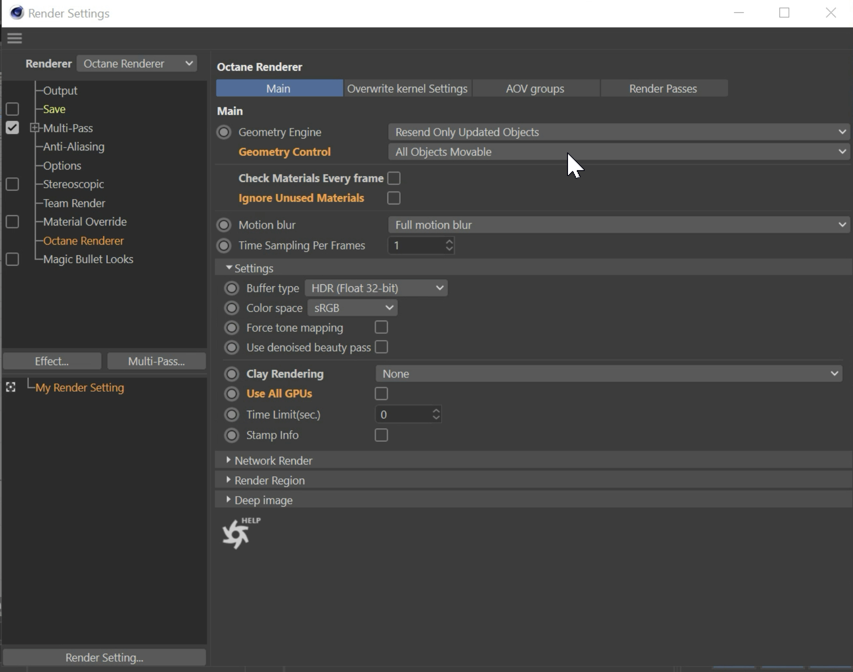

Please always select them then use the Convert selected materials command in Live View menu Materials.
Then go to octane render Settings/Main tab, and change the geometry control from Auto to All Objects Movable
Then disable the Ignore unused materials option.
About Use all GPUs command, use it carefully, and only if you know what you are doing, if you have a weak GPU in the system, it will be enabled as well, reducing a lot the available VRAM:
There are some missing textures in the scene, so they are also missing in Live View:
A part from that, after the above changes, the scene seems to render correctly in both Live View and Picture Viewer:
