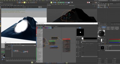

It's easy if you use "C4D gradient" with xpresso. Additionally there are different options as writing osl script. But this is easiest. See picture for setup.

Walkinghome6 wrote:This looks awesome. I need this scene file, lol ;)
It shouldn't be hard to recreate from picture anyway check the scene.

Wow, thank you so much. That is the simplest setup I could have imagined.
I was trying to figure out how you got the gradient into Xpresso, but found out just now that you view the material in the attribute manager and drag the texture tag over. Thanks again, I will probably use this often to feather out complex mograph setups.
