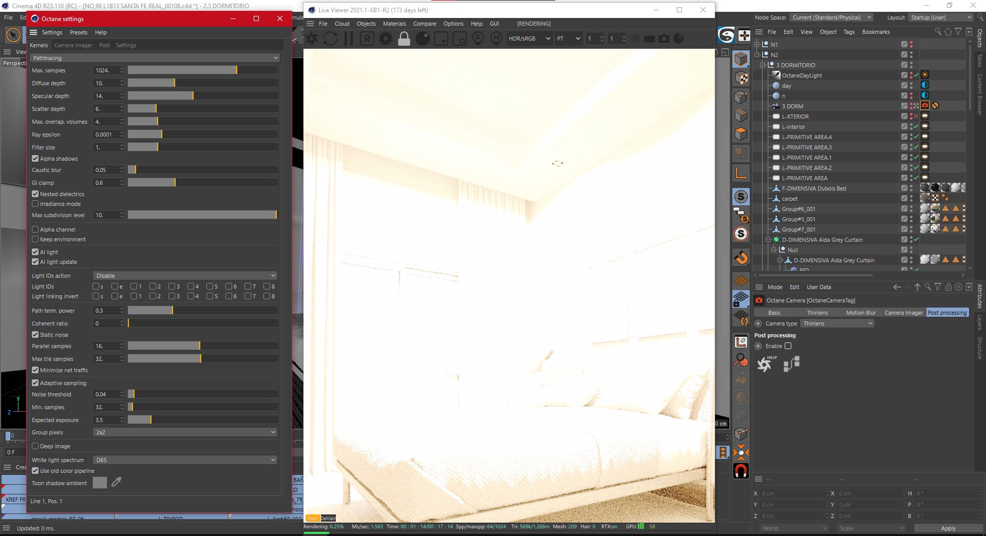

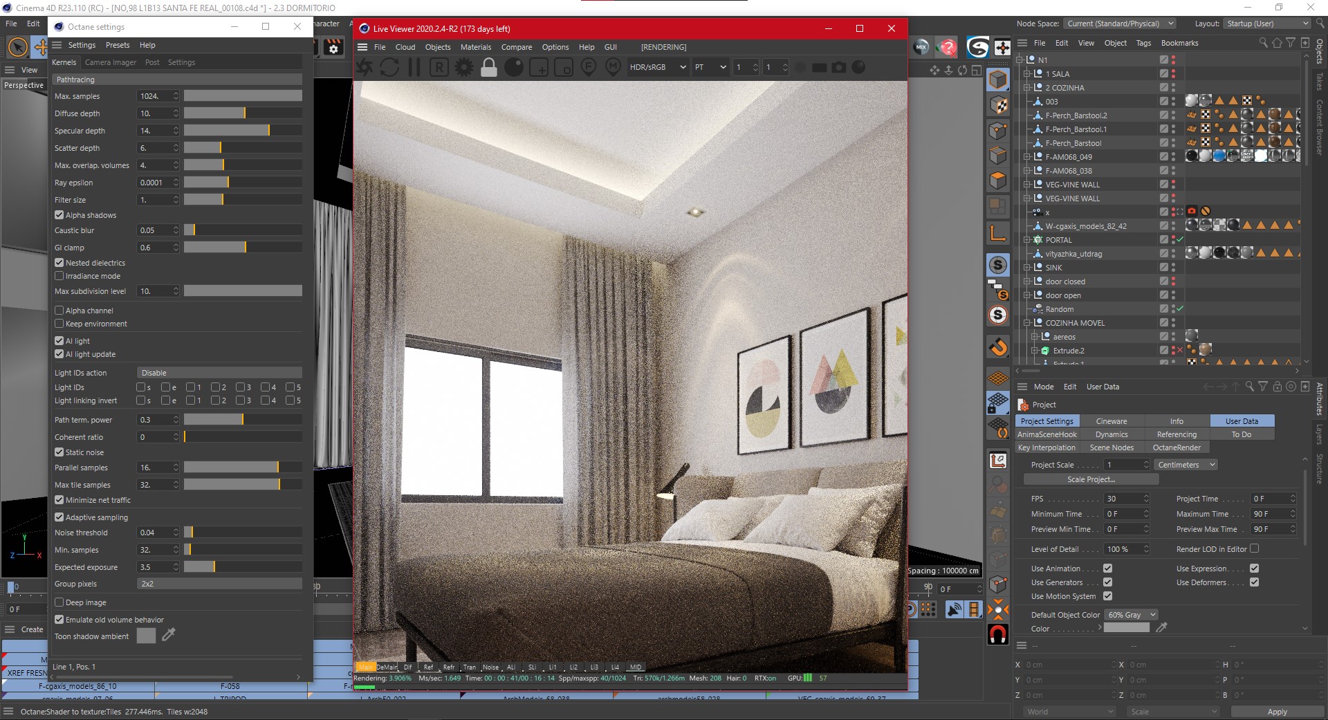

I have this scene which is giving me 2 very different outputs (2020.2.4 R2 and 2021.1 XB2).
Any ideas?

2020.2.4 R2 version
2020.2.4 R2 version
2021.1 XB1 R2 version
C4D 2025.3.3 Octane v1.9.4 // Octane SA 2026.4, Windows 11 Pro, X399, AMD TR 2950X, <<2 X 3090 + NVlink>>, 128 GB RAM, Corsair 1500i - NVIDIA SD 610.62
Octane User since V1 Beta
Posts: 10621
try to enable Multi Light, to check them one by one, maybe it is related to IES lights :roll:

Kalua wrote:I have this scene which is giving me 2 very different outputs (2020.2.4 R2 and 2021.1 XB2).
Any ideas?
Regards,
I have the same exact issues. I was able to get it close by adjusting my IES light output +/- 1000x less to get approximately the same results. There is definitely a problem here.
Any ideas?
Regards,
Sure something is going on. The point is we should have it fixed for future builds.
Or never import ongoing projects to avoid this problem - just make sure this is something expected by the developers or not.
