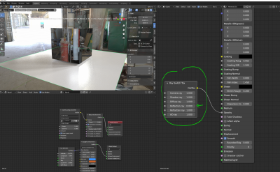

Hi there,
sorry for my ignorance but is there someway to remove a object from reflecting in another object?
ie I'd like to not have the floor reflect in the glossy cube, but I can't use a Shadowcatcher material as i'd like to keep a reflection on the floor and I'm pretty sure Shadowcatchers don't have a roughness setting.
Hopefully that makes sense.
Thanks in advance.

Yes you can, using the Ray Switch Texture node:

Awesome thankyou linograndiotoy
