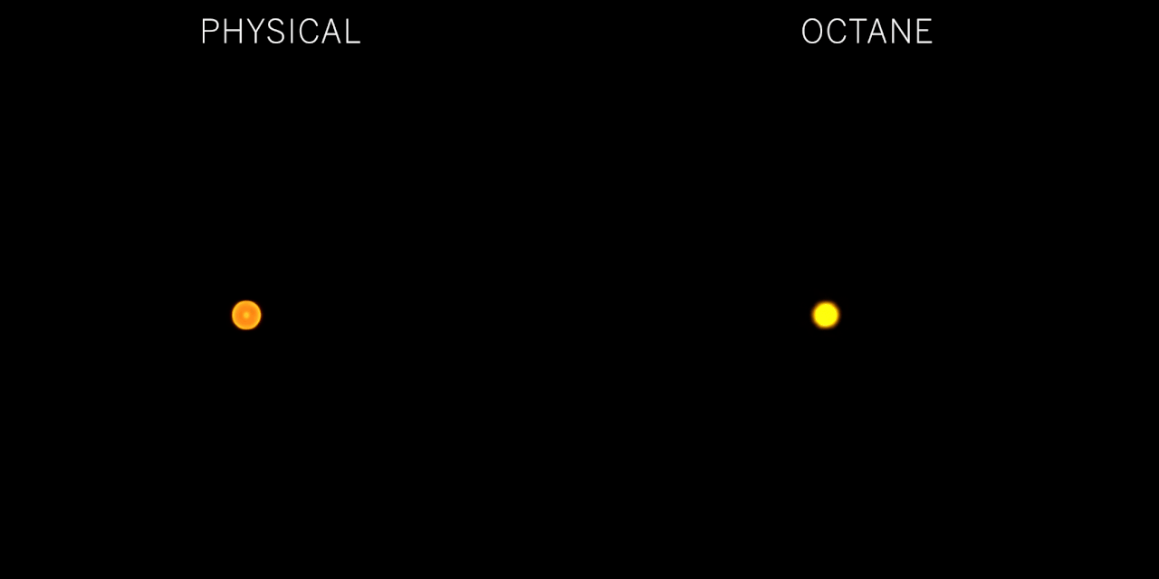

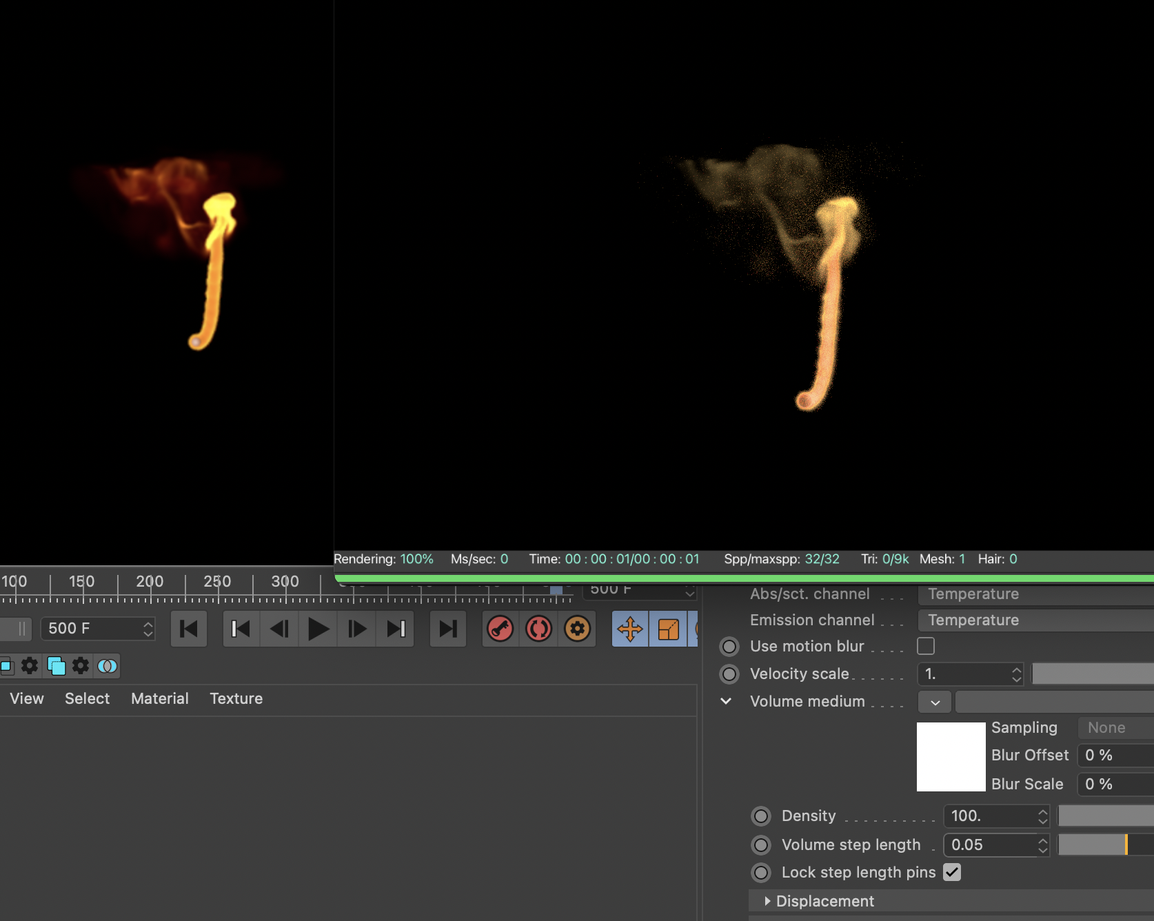

Is there a trick for getting it closer to the physical render?:
Physical vs Octane
Physical vs Octane
EDIT: Lowering the Volume Step Length seems to help brighten it, but still a bit washed out:
Physical vs Octane
Physical vs Octane
Volume Step Length
Volume Step Length

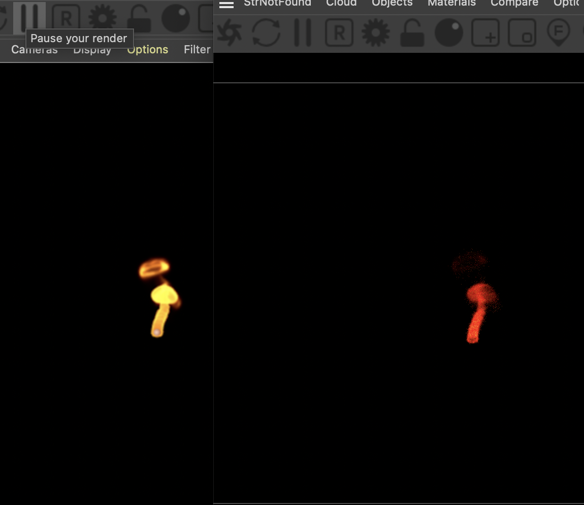

Interestingly, if you copy and paste the gradient from the TFD object onto the Object Tag, you get this (on right):
But it's very red.

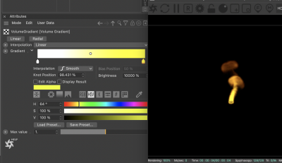

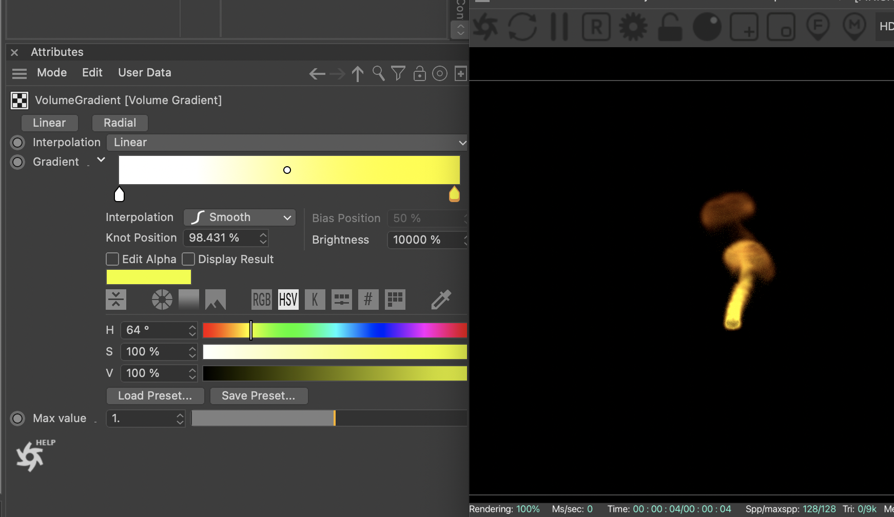

The closet I can get is by deleting the red and adding a Yellow to White Gradient, with Max Val 1:

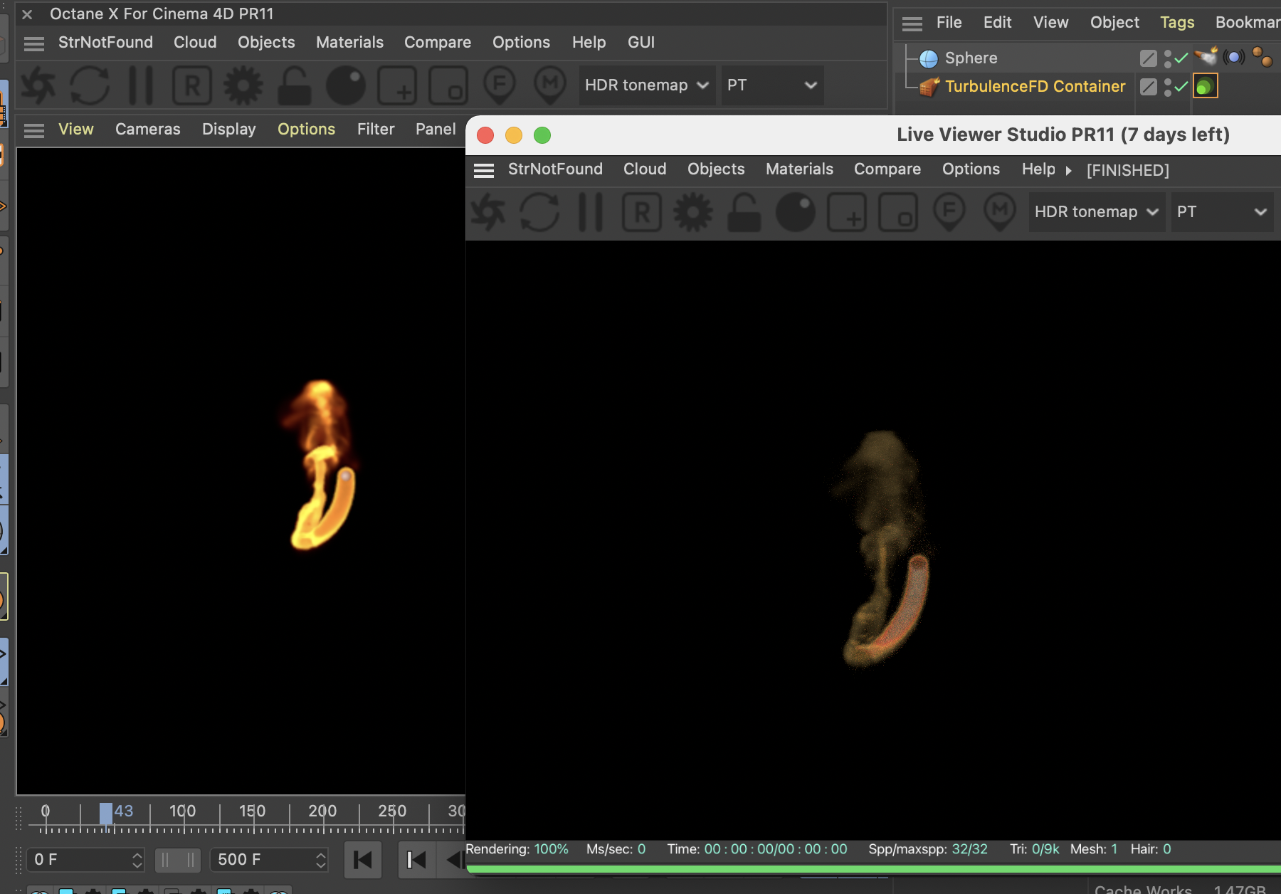

But it's still not quite there, the Physical render looks much nicer:

Try making your Max value 10,000
Puget Systems / Intel Core Z790 ATX / RTX 4090 / Cinema 4D
atoyuser1
Posts: 212
Joined: Sat May 02, 2020 1:10 pm
jayroth2020 wrote:Try making your Max value 10,000

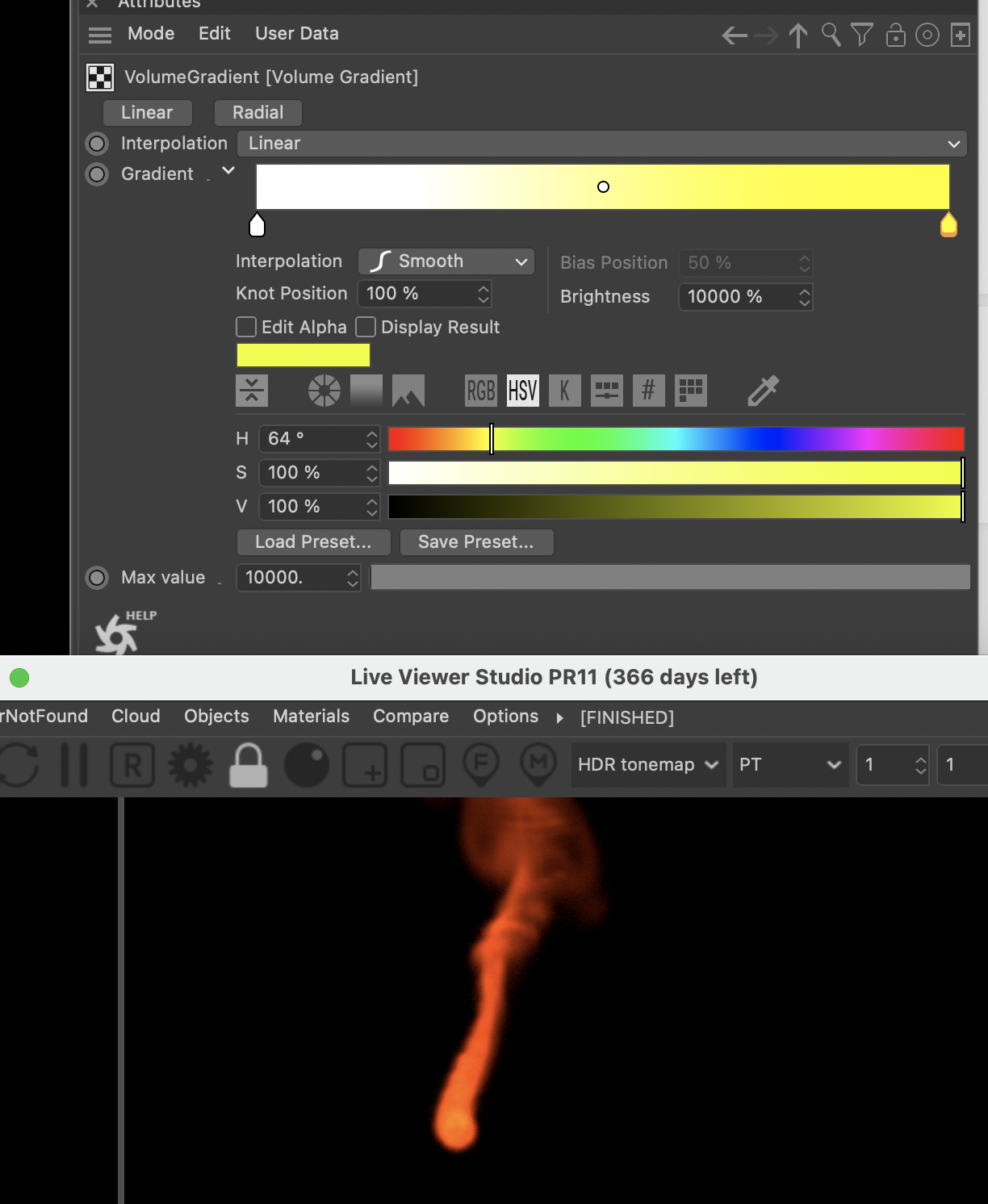

Thanks for replying jayroth2020, that made it red tint:
Max value 10000 yellow white grad

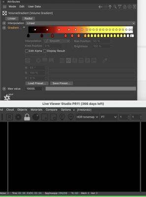

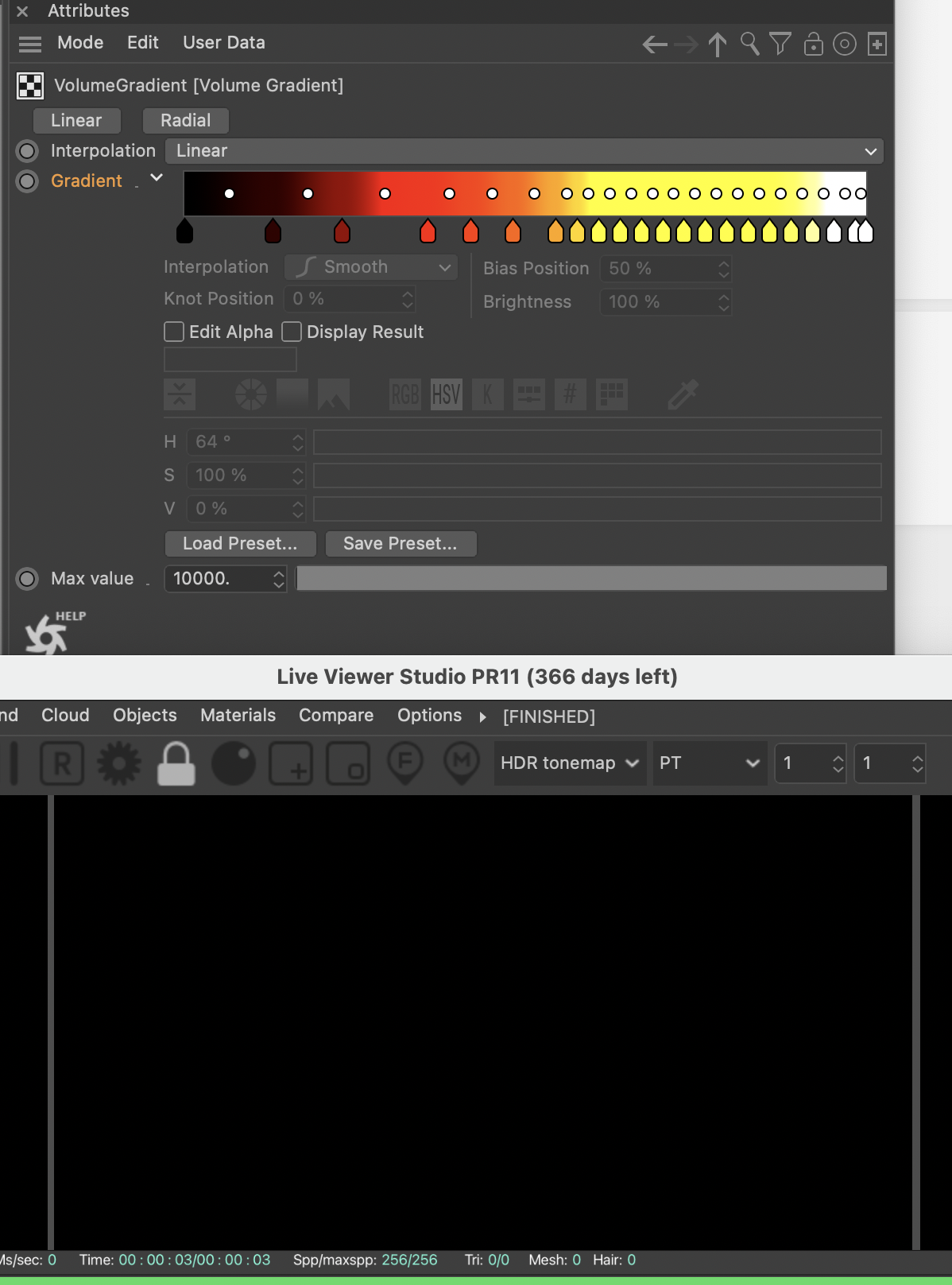

So I tried using pasting grad from the TFD object, but it vanishes:
Max value 10000 TFD grad
Feels like TFD is better suited for smoke than fire, at least in Octane. It just looks like fire-coloured smoke

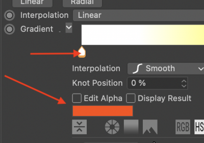

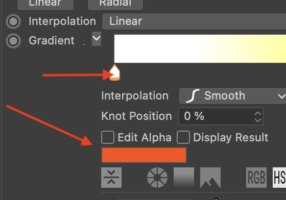

Incidentally, I might point out that the white in that gradient is actually orange:
White is actually orange
No idea why it's doing that
