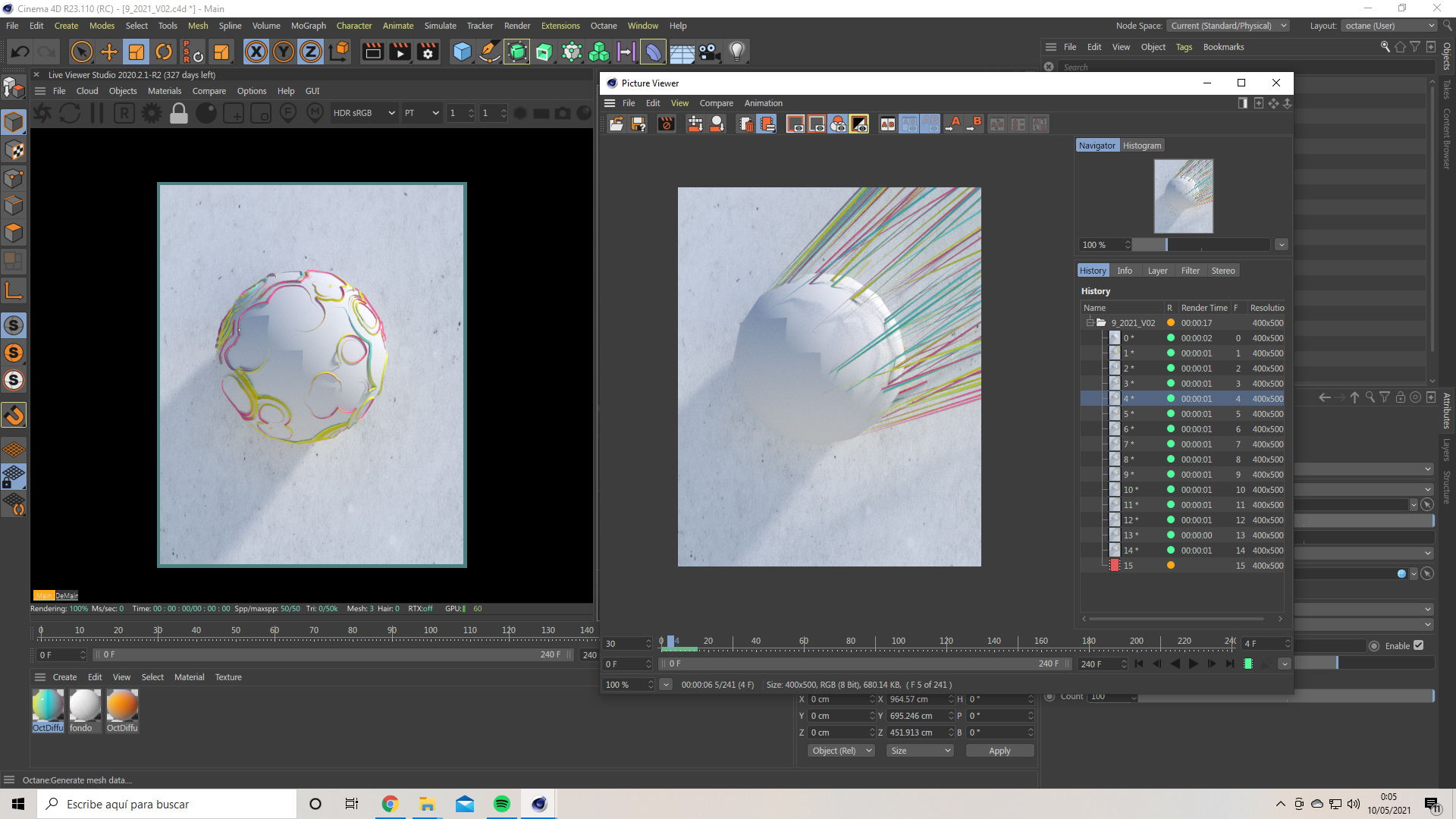

I have this problem. The live viewer display the project perfect but not the render.
I made several renders and it failed at some attempt, I try again and it goes ok, and then it stop working forever.

Its thinking particles with a tracer.

Render and live viewer don't display the same image
1-Test it standard renderer.
2-Check for the effects which require caching.
Another issue. I'm using a gradient shader on the material, and colors of live viewer and render are different, the same three colors of the gradient but in different positions. It should be any issue with mograph cache. Any idea of what could this be possible?.

Any visual info would be appreciated to don't lost the time. No idea what and where do you use. There's two modes for gradient/c4dnoises if you check nodes. Baking or osl emulation.Cristal wrote:Another issue. I'm using a gradient shader on the material, and colors of live viewer and render are different, the same three colors of the gradient but in different positions. It should be any issue with mograph cache. Any idea of what could this be possible?.
