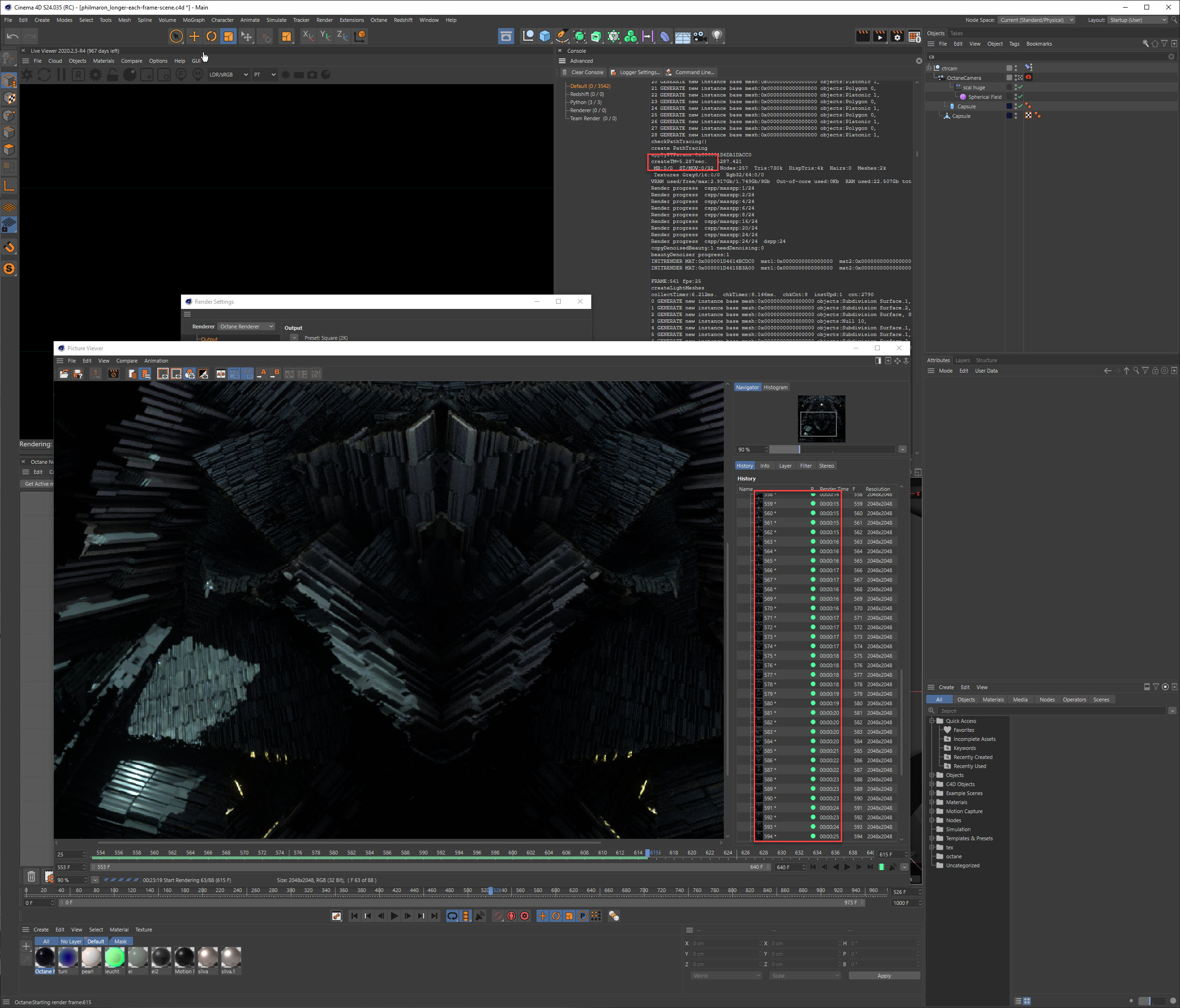

It seems to be "Start Rendering" which takes more and more time. In this scene I have 15 seconds for the 2nd frame, and 1 minute for the 100th frame, 1:42 150th frame... c4d and Log attached. The problem does occurs with every scene right now, but this is very good example.aoktar wrote:take look for render statistics for the frames. Check where they spend time and compare render speed

Sounds like a hardware stability issue. My render is going consistent. Can you post a screenshot with PV? I see long scene creation times in your log, about 85 secs. Mine is 5 sec. It's very strange.
