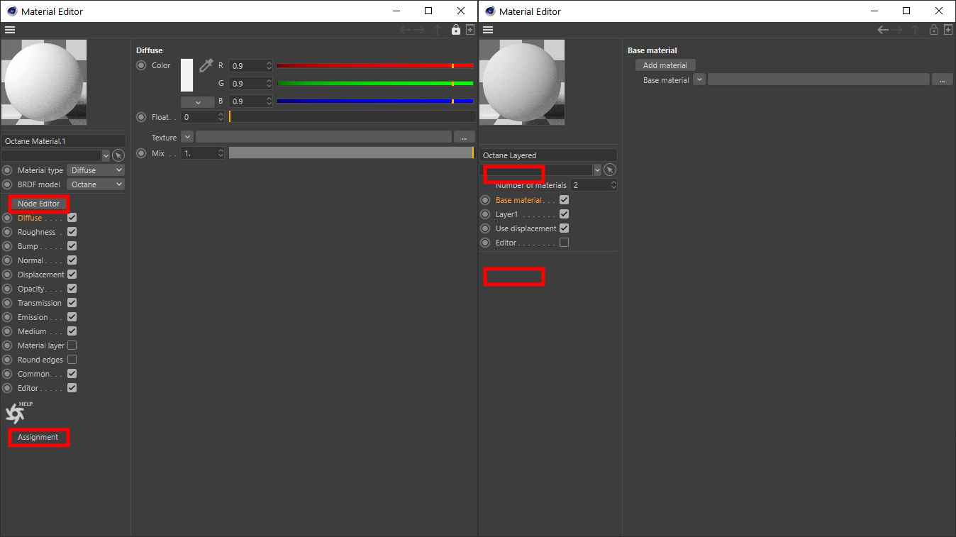

Manopim wrote:Hi Aoktar
2 little things that i identified in the last build and maybe are also present in the early ones.
- Assignment link on the material window exist only in the Octane Standard Material, it should be on all of others (Layered, Composite etc.) it's a very handy thing
- The "Node Editor" button doesn't work on Layered Material.
Best regards.
Valeu!
Mano
1-I know but there's some technical reasons that doesn't allow me add it
2-I've fixed it for next build
Thanks for reporting these

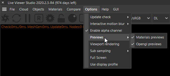

@Torque,
Disable opengl previews from this menu and compare the performance for lags. I'm not sure about your issue
Torquee
Posts: 14
Joined: Thu Apr 04, 2019 3:41 pm
Many thanks Aoktar! Will try it!
