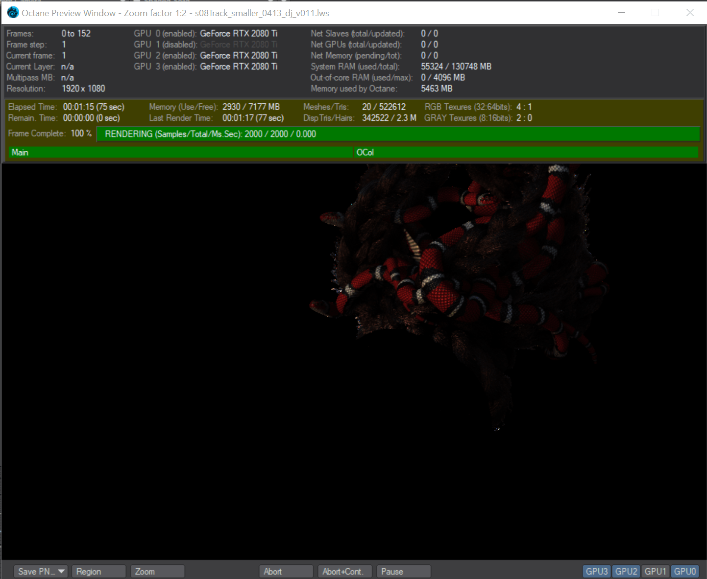

We're currently rendering a scene that takes 1 minute to render, but 10 minutes to "update" between frames.
Granted, the scene uses FFX which may play a (large) role in that, but I'm wondering what other factors determine the update speed?

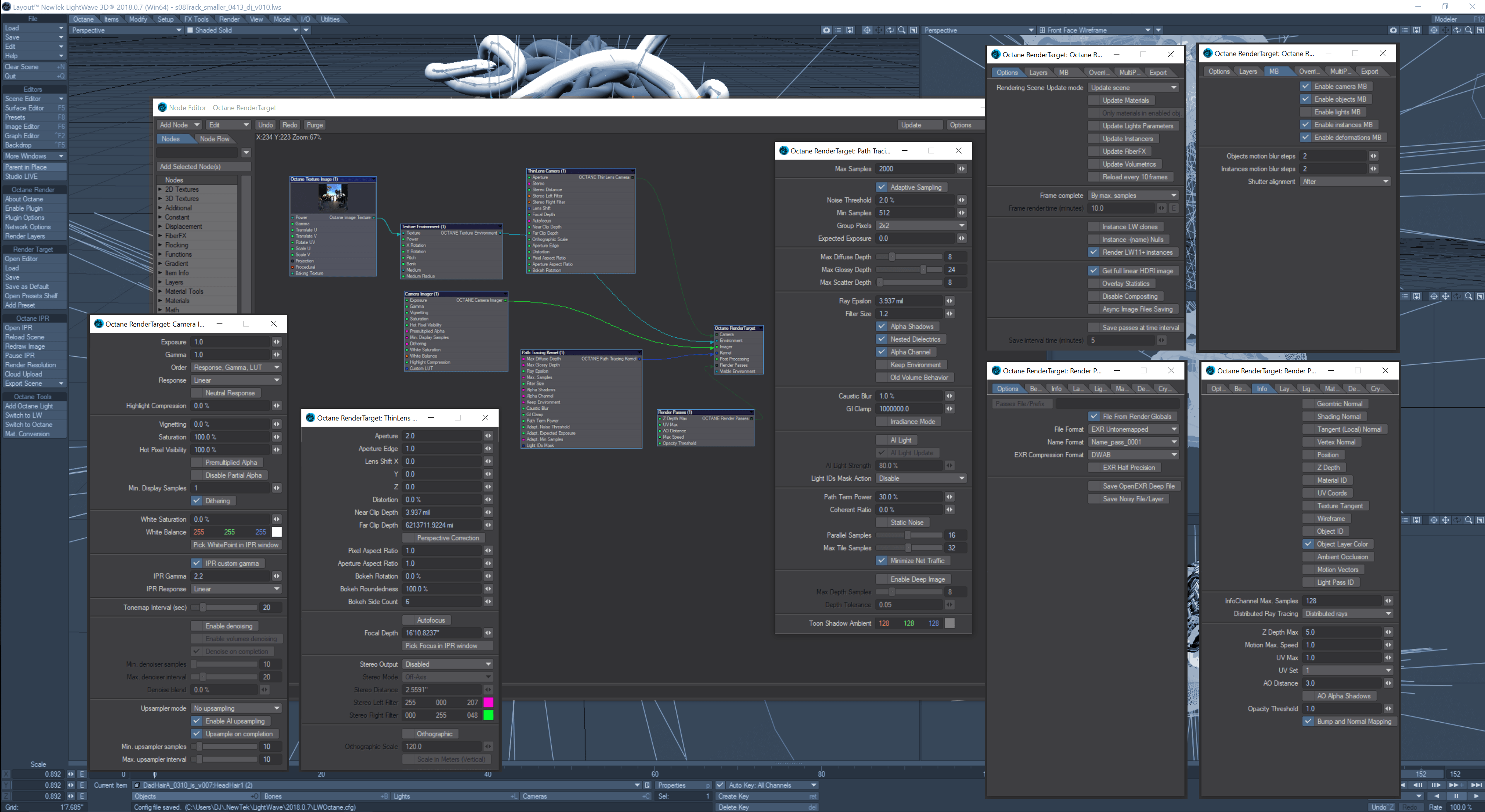

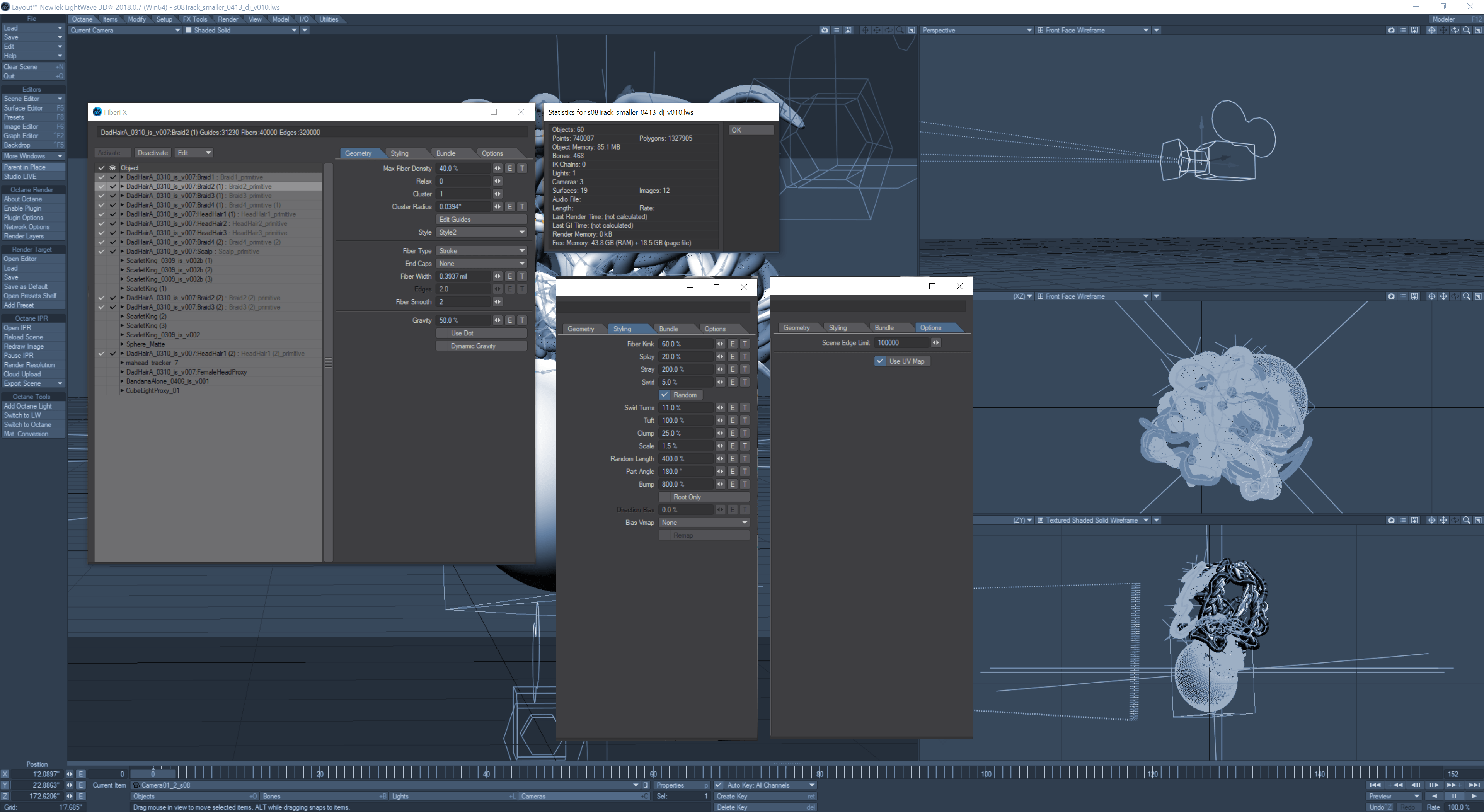

abledavid
Posts: 9
Joined: Sat Jul 23, 2016 12:57 am
Thanks for looking at these.
If you need more info, please let me know.
The FFX settings on each of the braids are slightly different, but only in terms of fiber density and minor styling changes.
Logs and settings attached...
