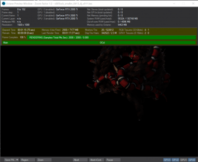

We're currently rendering a scene that takes 1 minute to render, but 10 minutes to "update" between frames.
Granted, the scene uses FFX which may play a (large) role in that, but I'm wondering what other factors determine the update speed?

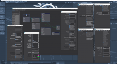

The FFX settings on each of the braids are slightly different, but only in terms of fiber density and minor styling changes.

Yes, the problem is that LightWave spends around 3 minutes to update the scene for each motion blur time sample (3 samples for the standard 2 steps MB). The only workaround is to disable the motion blur, but well, I suppose that this is not an option. In other apps. like Houdini, all the scene information can be exported to cache files to avoid this problem, but I'm not sure how far you can go with this workflow in LightWave.
