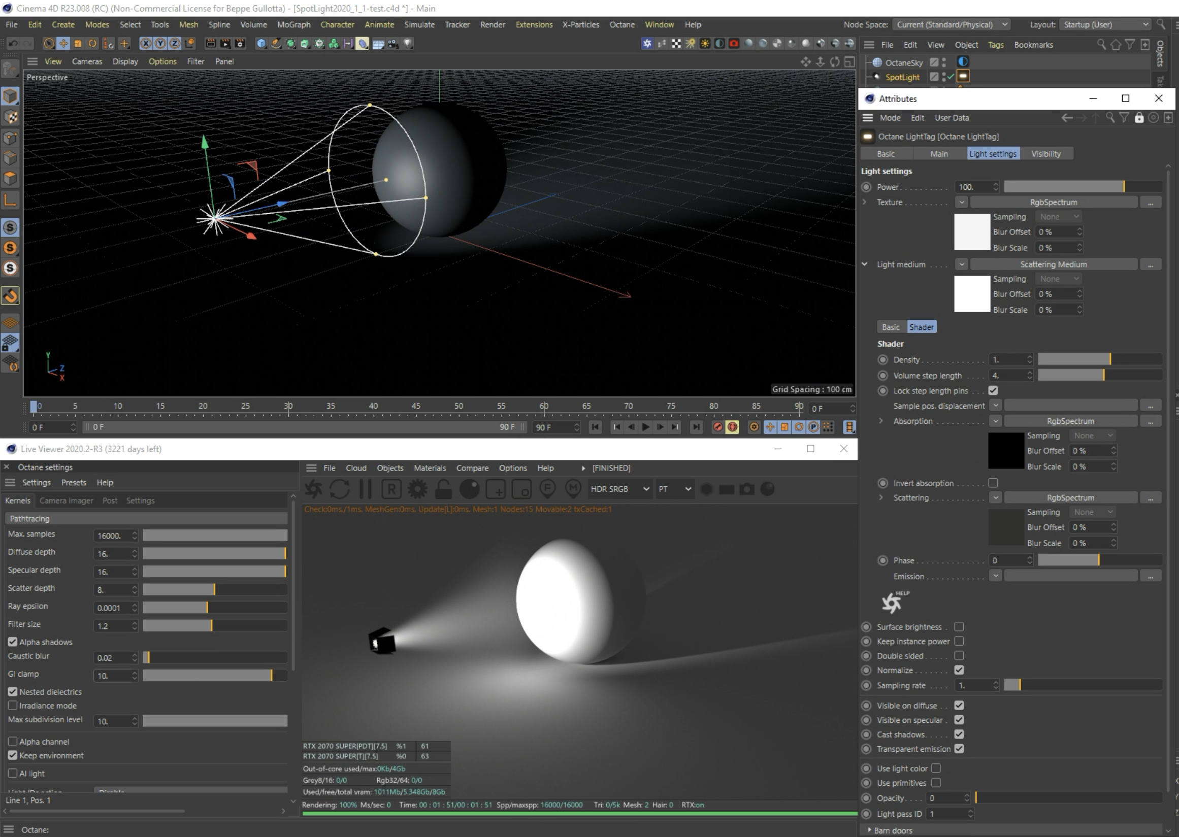

Posts: 10555
you need to remove the Scattering medium node in the attributes of the Spotlight, or adjust its values to have a more correct volumetric effect:
![](download/file.php?id=83698&mode=view)

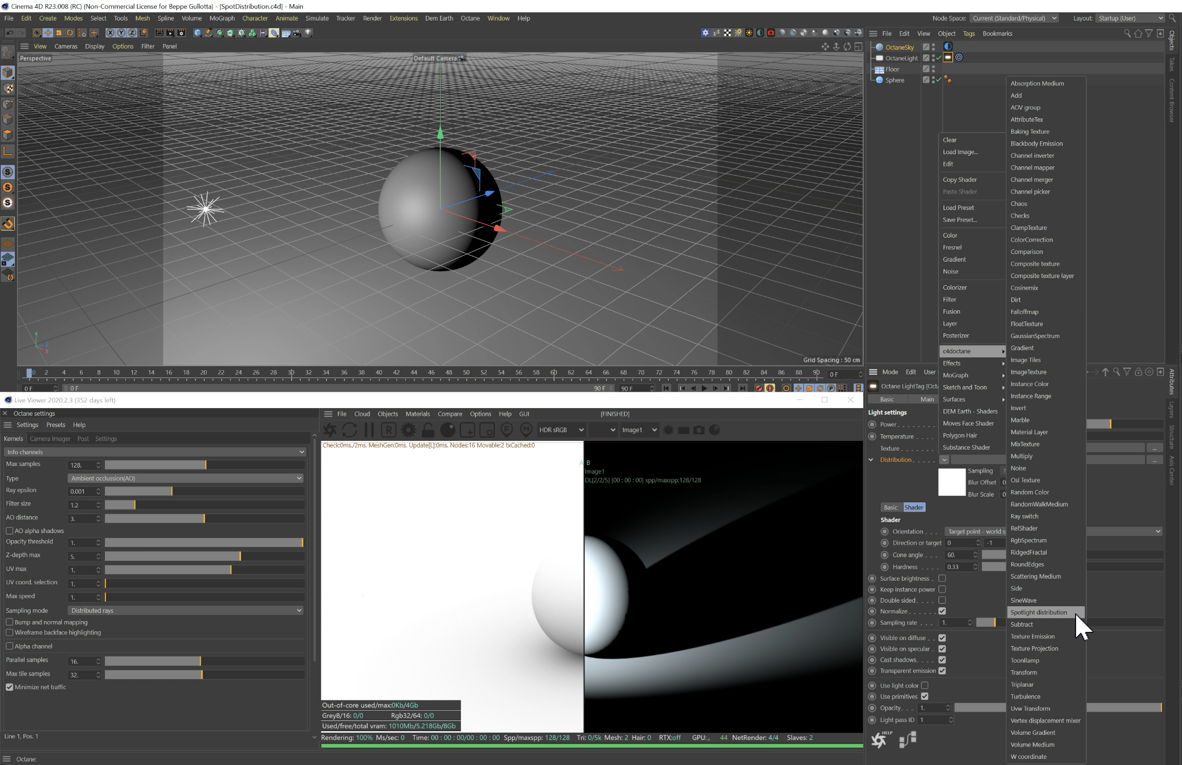

Posts: 10555
Ok, now the issue is more clear.
The solution is to replace the Volume SpotLight with a normal Area Light with reduced dimensions, and add the new Spotlight Distribution node in the Distribution pin:
Here is an example scene:
SpotDistribution.zip
(73.17 KiB) Downloaded 276 times
ciao Beppe
