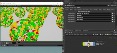

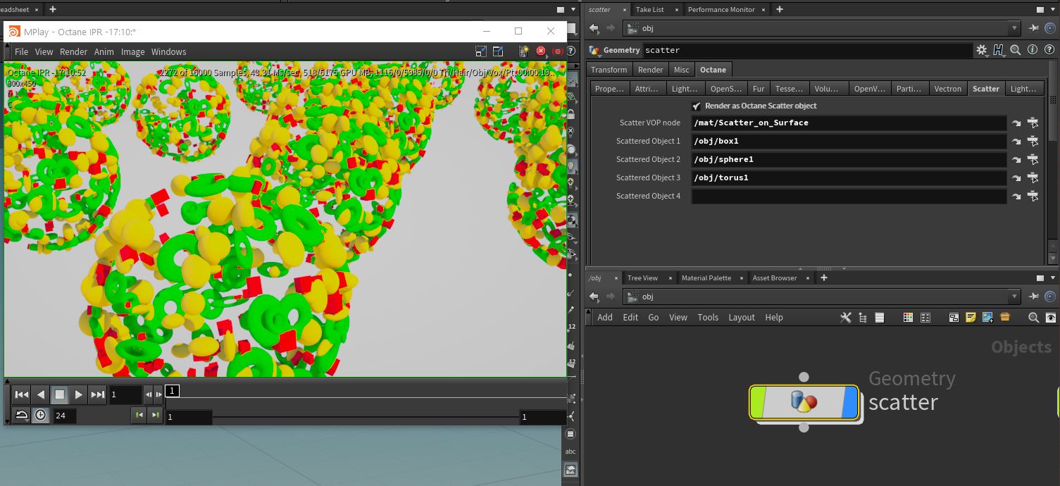

In Houdini this feature works enabling the "Render as Octane Scatter Object" option in the Octane OBJ spare parameters. The scatter is configured from the scatter VOP nodes. Attached you have an example scene.
Thanks,
-Juanjo
30-scatterNode_01.zip
(82.95 KiB) Downloaded 588 times
theshizon
Posts: 14
Joined: Fri Aug 28, 2020 5:07 pm
Ok I see. Thanks! I was looking for nodes to plug into and out from the Scatter on Surface. So it doesn't need anything plugged in it just needs to exist. Awesome! Same with the materials too huh? I thought you needed a material out connected after your materials. Good to know! Cheers!
