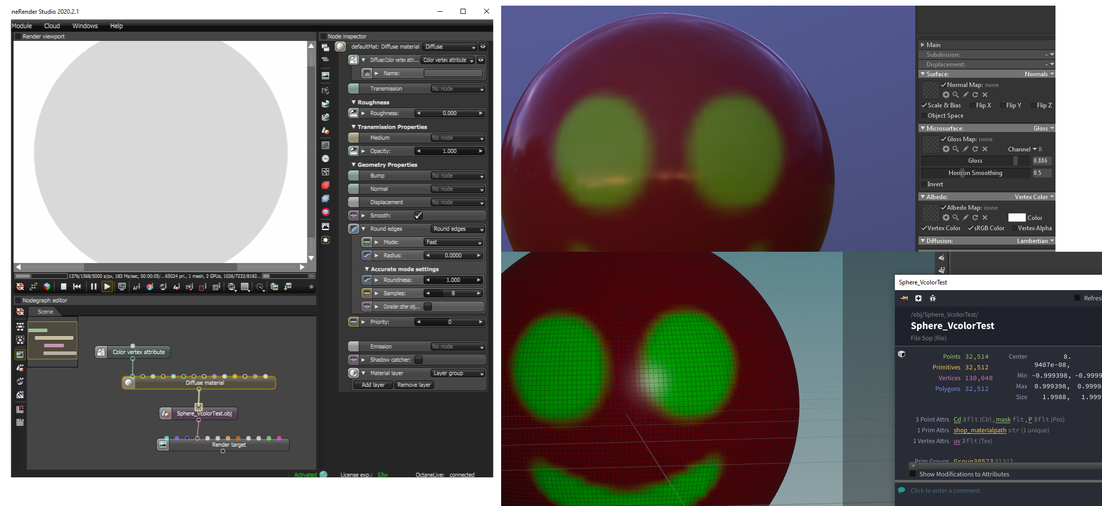

I am trying to read the vertex color from zbrush FBX file ( polypaint)
I saw the color vertex attribute node inside diffuse options, and set up the proper Col name, it work in Blender but it still remain white in OCtane.
Anything to do to make it work with Octane? would be amazing.

I'm using octane 2020.2.1
It's maybe because i'm not setting up correctly, look at the image. the same object imported in marmoset and houdini get vertex color.
I tried alembic but it doesn't work at all (even in houdini and marmoset), i think Zbrush don't put vertex colors infos when exporting alembic.
