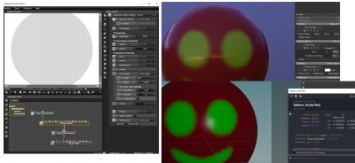

It's maybe because i'm not setting up correctly, look at the image. the same object imported in marmoset and houdini get vertex color.
I tried alembic but it doesn't work at all (even in houdini and marmoset), i think Zbrush don't put vertex colors infos when exporting alembic.
