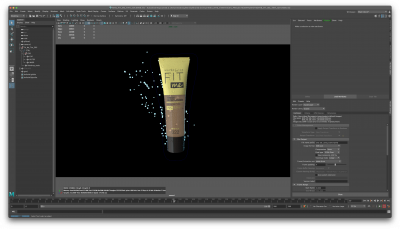

I have a .abc fluid sim exported from Houdini imported into Maya. When the Animator Data is set to "don't load" it shows up fine, but obviously frozen at the first frame. When I set it to "force load" it disappears from the render. I tried it with Constant Topology on and off. I've worked around it by importing the .abc in Standalone.

Oh interesting. I have tried it with the shutter speed set to 0 and more than 0.

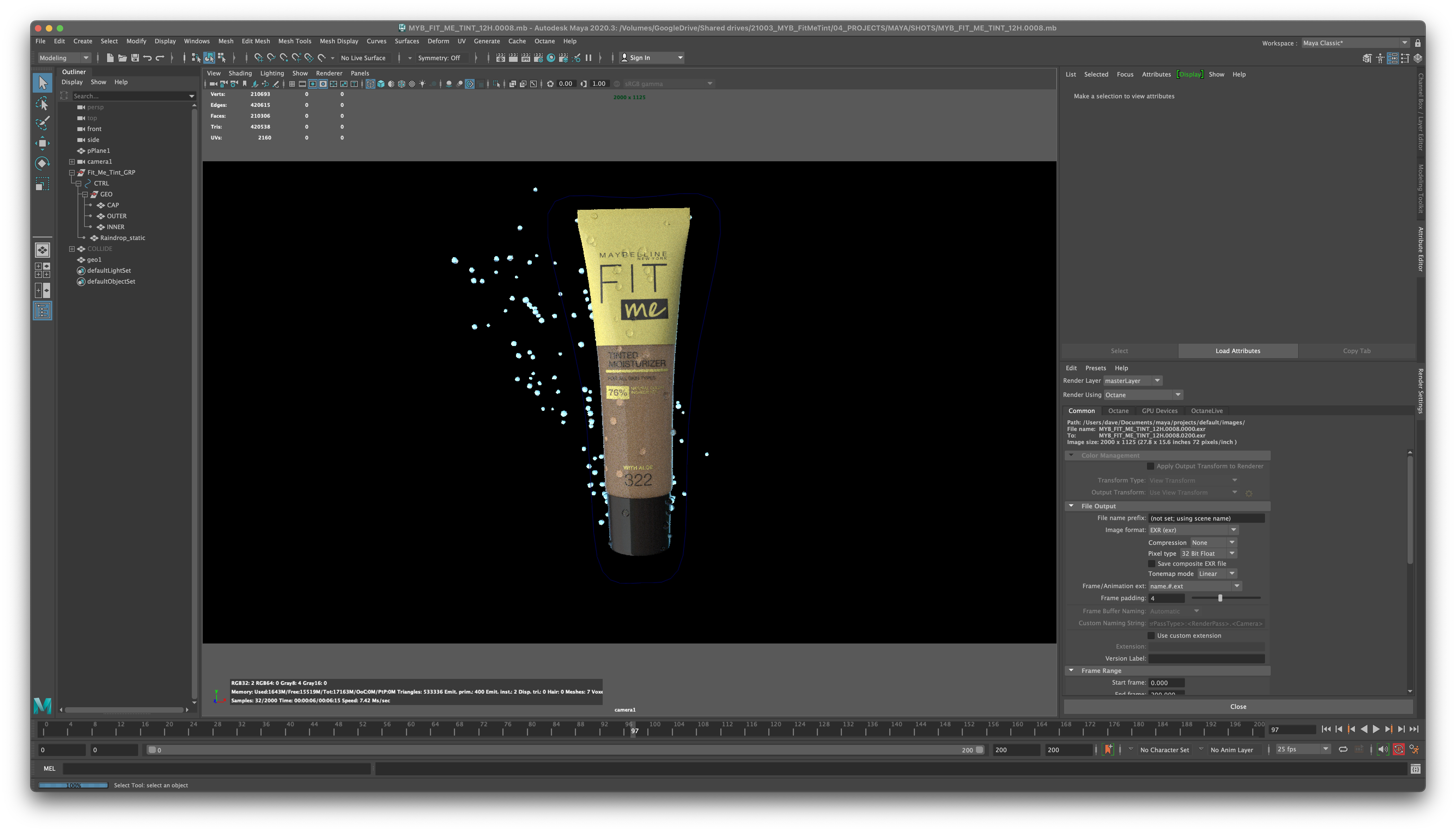

I've attached a video of how it works in Maya for me. With it set to Force Load it is invisible. Once its set to Don't Load it shows up fine.
This is the case for all .abc for me. Maybe I'm missing something, but I know I've done this sort of thing a lot in the past and it's worked fine. Thanks for looking into it.
Update: the other .abc in the shot actually works fine with Force Load. But it has constant topology.
