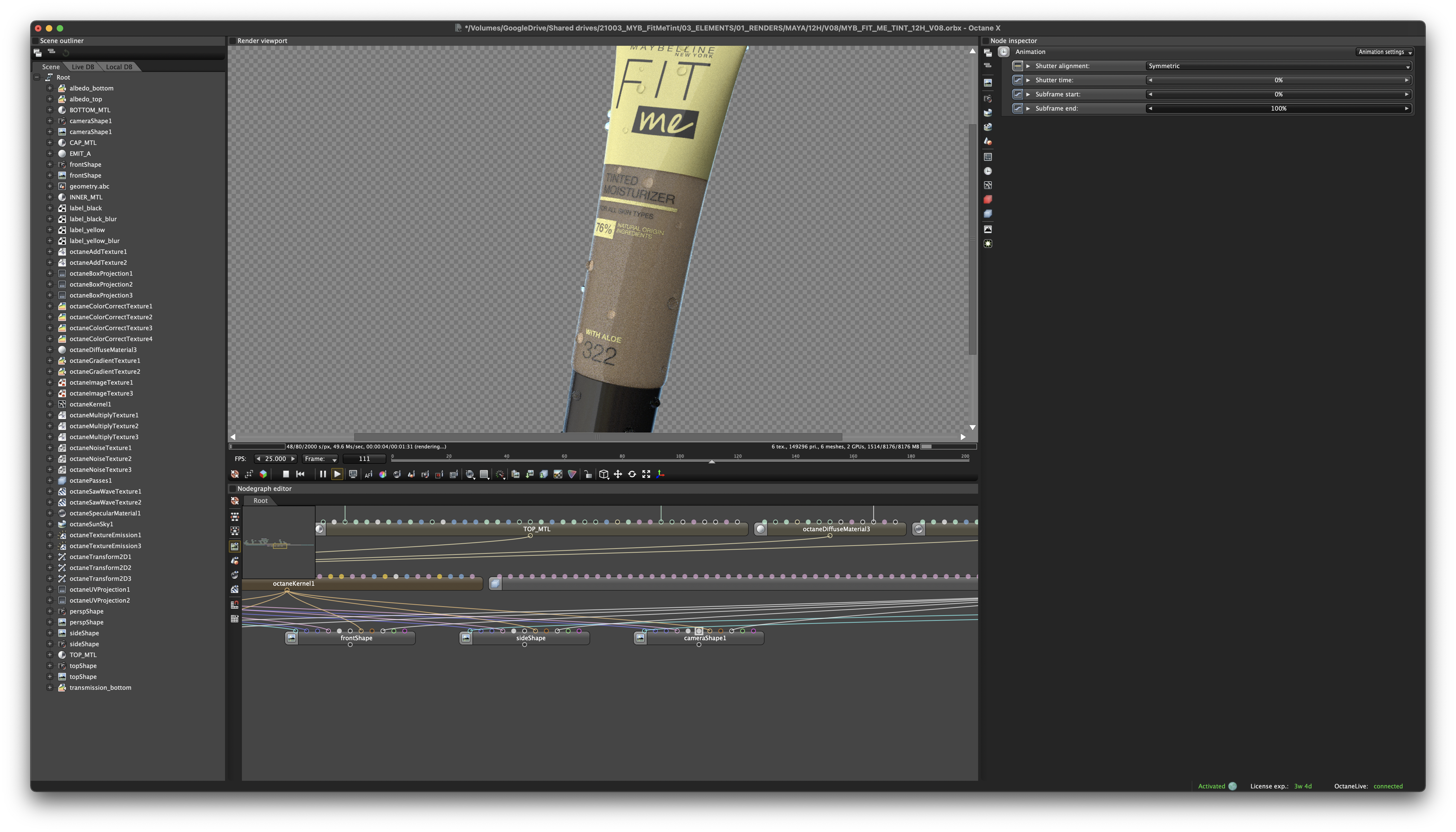

The plot thickens...The alembic shows up fine in Maya if I turn the frame cache off, but it doesn't export to an animated .orbx.

JimStar
Posts: 3852
I have a guess what may be your problem. Will do some workaround in the next version...
