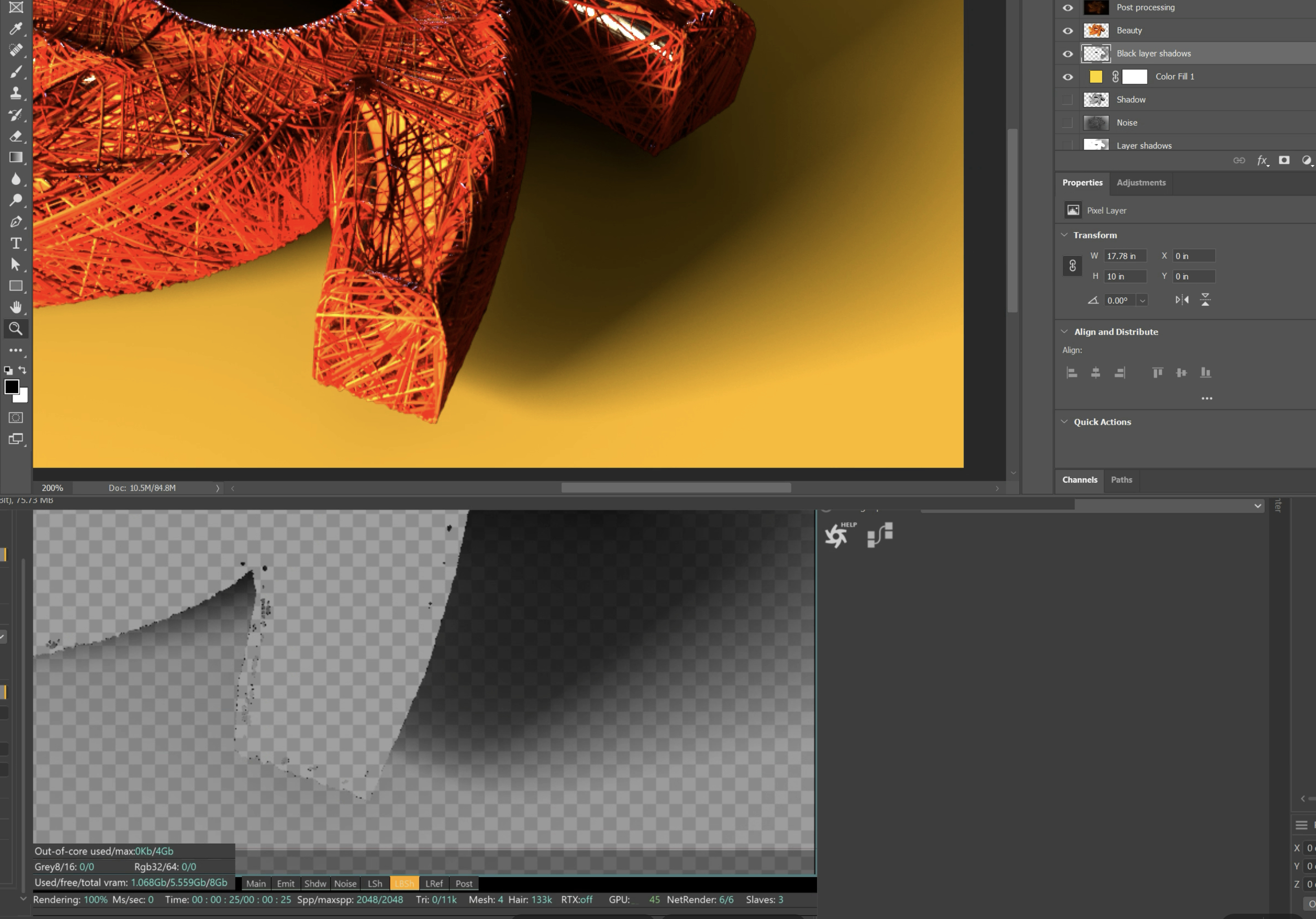

bepeg4d wrote:Hi paypal-ict,
please note that AI Denoise works only with few Beauty passes, so Render Layers, or Lighting Layers, for example, are not affected by AI Denoser.
You should need to render the black shadow pass with AI Denoiser turned off, greater Max Sampling, and Adaptive Sampling enabled.
The core devs are working to have an AI Denoiser pass on top of AOVs for future.
ciao Beppe
But increasing my sampling doesn't make any difference.
I'm already rendering at 3.000 Samples? It doesn't seem to behave like normal render noise.
There's several topics in the past about this same issue where it was fixed in Octane 2018.1?

Hi paypal-ict,
please try to export the scene to Standalone, and check if you have the same behavior.
If yes, please post the scene in this discussion:
viewtopic.php?f=24&t=77111
If not, please share the c4d scene with us, thanks.
ciao Beppe

bepeg4d, have written about noisy shadow pass may be several times (no matter with samples max)
I still don't see any changes for the better )
By the way, you gave me a recommendation to DISABLE adaptive sampling
and to the user paypal-ict - you said to ENABLE adaptive sampling
Where is the truth?))
Posts: 10480
Hi desire,
unfortunately the isue with Render Layer Layer Shadows, or Black Layer Shadows, is not reproducible here from a long time, with or without Adaptive Sampling active, so it is very difficult to help.
Here is the Black Layer Shadows pass at 2048 sampling, without AI Denoiser, Adaptive sampling enabled, and zoomed at 200% in both Live View and Photoshop:
And again, since this kind of problems are not plugin related, but general SDK related, I’m asking you to export to Standalone and share an .orbx file that shows the issue with the core devs in the corresponding Standalone discussion here, thanks:
Happy GPU rendering,
ciao Beppe
