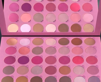

This is how the render is coming out, even though it's set to 250 samples (PT) and the denoise is deactivated

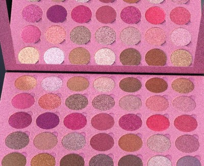

This is how it should be, without denoise

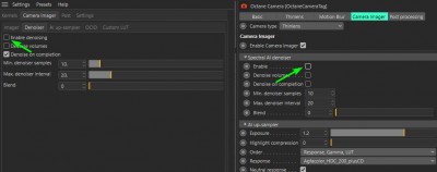

These are my settings for this shot:
Kernel and active camera settings on denoise

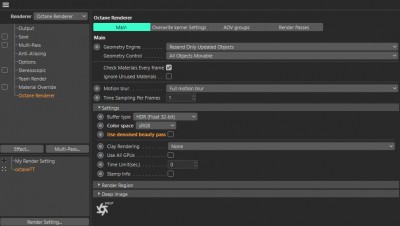

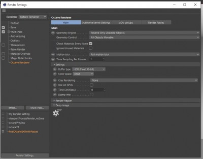

The option "Use denoised beauty pass", which has always been present in the Main Octane tab, but had disappeared for sRGB in these versions that I prior mentioned, simply came back. That certainly solves the mystery.
Some images illustrating:
This is how the Main Octane tab is today, with the option to "Use denoised beauty pass" visible
This is how it was some days ago, without the "Use denoised beauty pass" visible while in sRGB mode

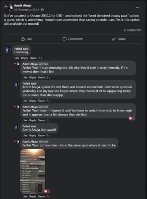

I've even found this Facebook thread while browsing for a solution some weeks ago.
