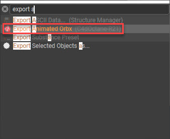

You can do with a simple script
command for exporting orbx
