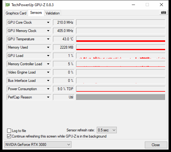

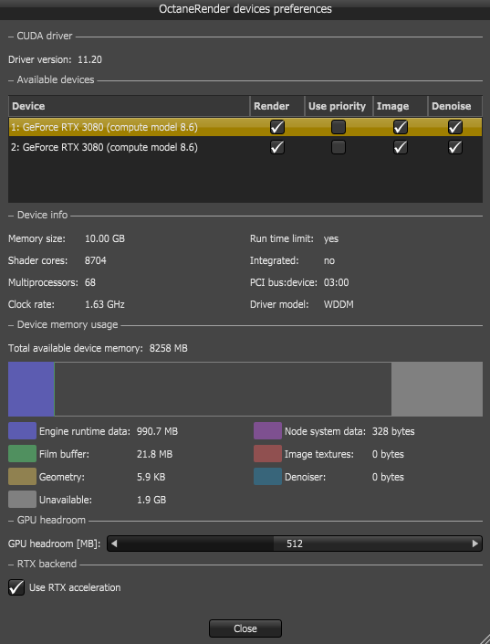

Hi Beppe;
Sorry for the delay. Here are the screenshots:
Idle system no Cinema4d instance is running:
C4D open with empty scene:
Octane rendering a Cube:
Octane rendering a complex scene:

Posts: 10643
GPU-Z shows 9869MB of memory used in the complex scene, so it is too high for your GPUs.
Roughly you should have max ~7.5GB of available VRAM, so it means that ~3GB of the scene has been moved to Out-of-Core, and the speed has dropped of %20%, isn’t it?

Hi Beppe,
Here's the stats from the complex scene. It seems i'm not using ooc at all.
