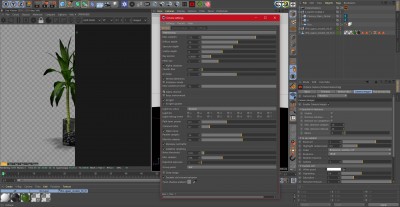

thanulee wrote:Hi,
Is there an option to remove this square from the middle of nodes? I find it inconvenient, as I am used to double click to remove a wire and this gets in the way very often.
See image below. Thanks
It's for quickly adding new nodes, double click to remove it's still here.

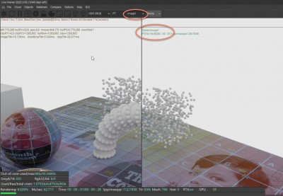

thanulee wrote:Hello,
R20 has a problem with store render buffer and renaming the stored images. See video below
eg. im pretty sure render region has issues, I couldnt reproduce now but already happened to me few times
https://www.dropbox.com/s/jms6voypcevdo ... .webm?dl=0
Please give some details because it's not reproducible for every case. Need to know what causes that.

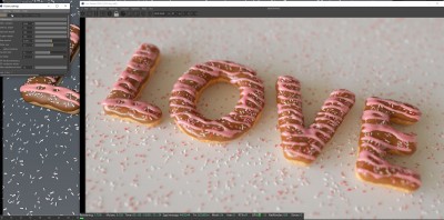

SSmolak wrote:If "Use Octane for OGL Previews" in Settings is turned on changing color doesn't update in viewports. LV OGL Previews is turned ON.
ALSO - is there way to support C4D Layers Solo Mode by Octane ?
Could you please give more info because it's working well
I will provide more info about render region if it happens again.
About store render buffer, it happens on all scenes. Just open live viewer and press store render buffer.
Also the images cannot be renamed. This happened in previous versions in 2020.1.4 that I was using.
Many thanks!

thanulee wrote:
aoktar wrote: About store render buffer, it happens on all scenes. Just open live viewer and press store render buffer.
Many thanks!
It's renaming but UI element is not refreshing the list but displays in render buffer. will try to add this support
Same here on R20.057.

aoktar wrote:
Many thanks!
Ah ok didnt know it works like this, I was expecting it to work on top. Not important just mentioning what I see (and probably some stuff havent used in prev versions).
