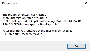

While rendering a quick preview in PV Octane crashed after few frames on my main workstation. (Standart C4D crash window Plugin Error: "The plugin octane.dll has crashed. More info can be found in 'C:\....\_BugReport.txt'...")
I restarted C4D and loaded the scene again. And the same C4D crash pop-up appeared right away, while the scene was just loading, before I even touched anything. (screenshot attached)
I restarted the whole system and tried again. And the same thing happened. And again, and again - the scene just wouldn't even open now.

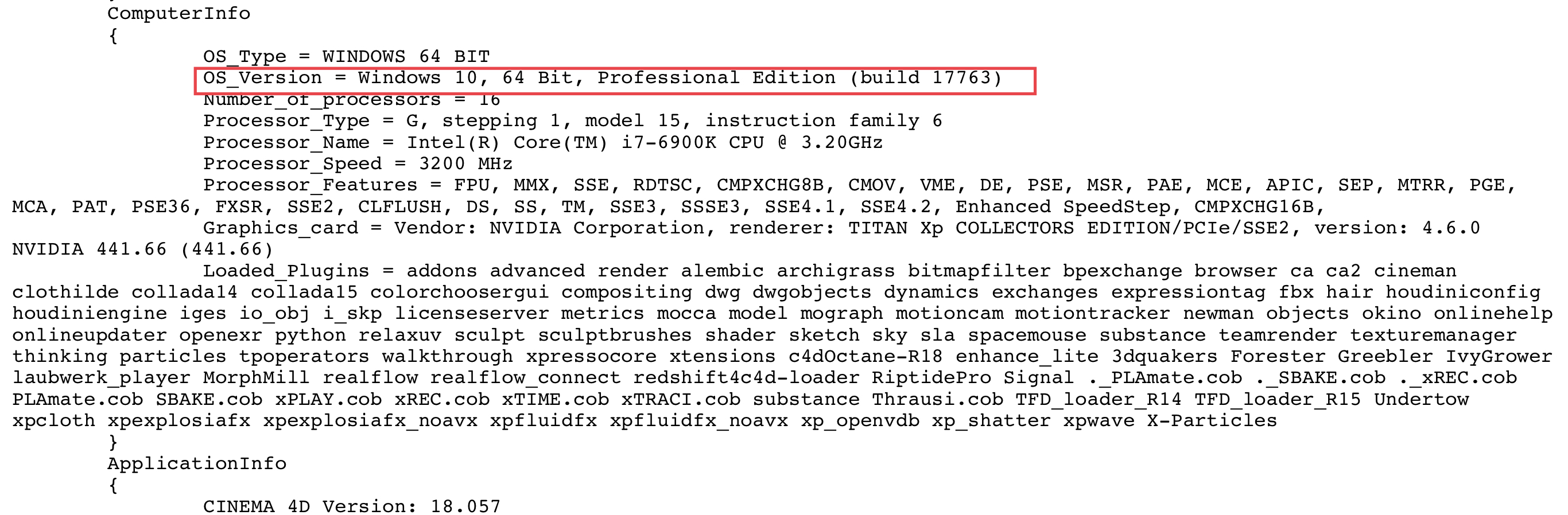

I attached Bugreport.txt that I got from the crash, not sure if that's any help, but I can't even get any other log, because it crashes C4D instantly.
Thanks for any help! I'm really at the end of my wits here and I desperately need to get it working.
_BugReport.txt
Report from the crash while loading materials
(427.63 KiB) Downloaded 323 times

Posts: 10651
the Win 10 version installed is very old:
Please upgrade Win 10 to 1903, to work with Nvidia Studio driver 441.66.
ciao Beppe
